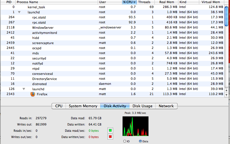

i have rpc.statd PID 264 and PID 267 running at 92% and 94%
my mac is 17inch 2.66 intel core 2 duo
4 gig of ddr3 ram
running snow leopard 10.6.2
its killing my battery life and i cant stop it can anyone help.
even with all aps closed it still is running at that speed.
here is a sample

click on the activity monitor window (make sure the drop-down is set to "All Processes" and its sorted by CPU)
Then there's a "Manage Attachments" button below the reply box in the forums.
attached is a screen shot

basically after i upgraded to sl it started to happen my battery life went from 4-5 hours down to 1.5- 2 so i started looking my fans are running crazy time and my temp is consistently up on the cpu 88 degrees even when nothing going on

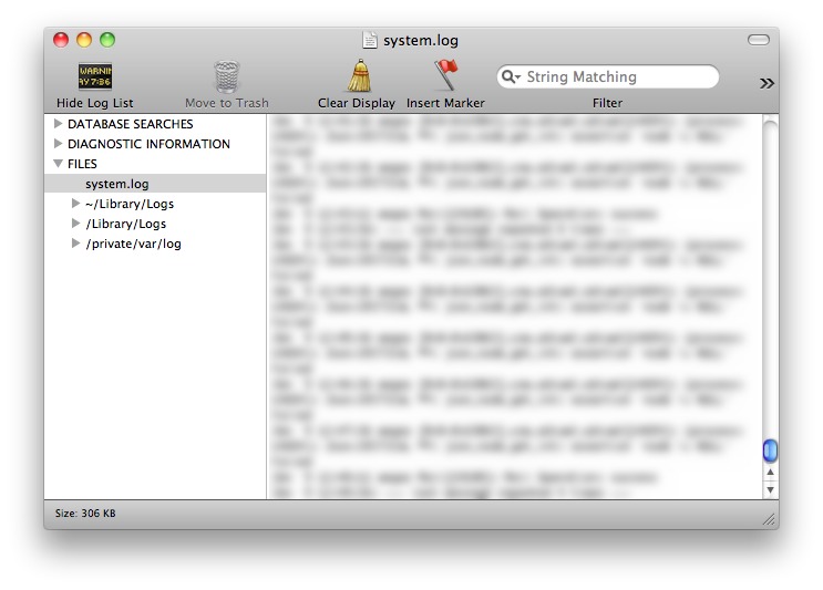

Use Console.app (/Applications -> Utilities -> Console). See the attached screen shot. You don't need to cut-and-paste a picture for us, just use the Filter (top right) to search for rpc.statd and see if there are a lot of lines that repeat themselves.

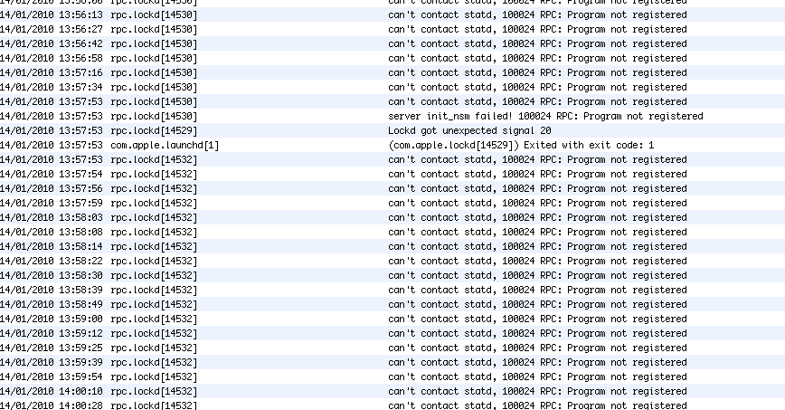

hi guys any idea what this might be on the console i keep getting this -
