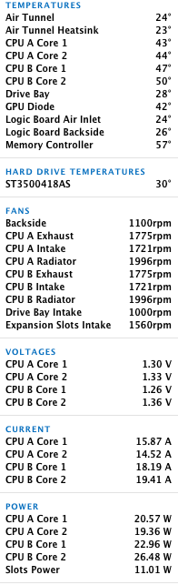

I have inspected my quad for any signs of leakage and there is none. I notice when I run the unit in high or automatic mode for the processor that the temps on CPU B can go to about 10 degrees Celsius hotter then A. Is this something I should be worried about. The fans also ramp up somewhat.
The temperatures in your attachment look just fine, especially if these were captured after running the unit on high for a period.
