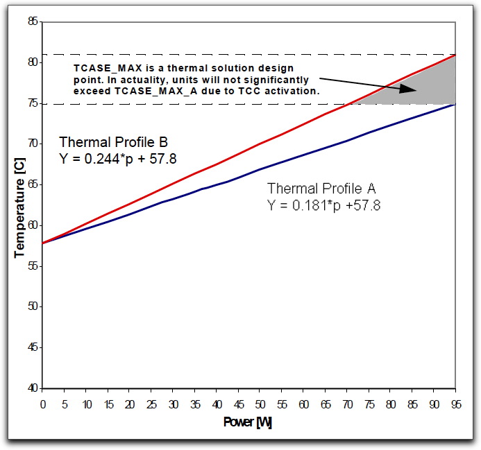

TDP (measured max at TCASE) for the Gainestown X5550 (95W TDP) processor is 81C for profile B.
Profile B basically relies on the processor's TCC to make sure it doesn't crash or worse break the
part. Ideally you never want your processor to approach this temperature. The max limit for the
saner safer profile A is 75C. The Bloomfield W3520 (130W TDP) the thread starter's processor, has
a listed TCASE max of 67.9C. Both of these assume an ambient testing model of less than 43.2C of
course and more suitably are performed in the low 30's.
Here's the graph from Intel showing both profiles for the X5550 (or really any of the X5500 series chips):
Intel says:

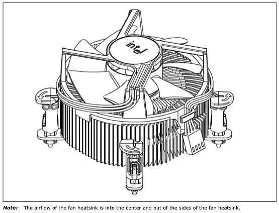

Arn't the Intel spec sheets based on the silly little heatsinks you get with the chips not the custom designed heatsinks in the MP?
As for limiting performance, in windows it still turbo boosts even with the chips hitting 80+C under 100% HT load.
Apple might have got extra special high temp chips.
The heatsinks in the Mac Pro (esp the quad) are bigger than any heatsink i've ever had. (and i've had extreme air for many years in my PCs...)

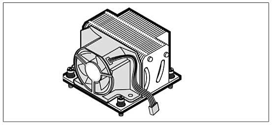

Yeah, but I dunno it I would call them "silly" or not. Here's the one designed for the 3500 series which is processor the OP has.
And here's the one for the 5500 series:
Notice the dual triple-pass alcohol/wick heatpipes and the custom fan shroud.
