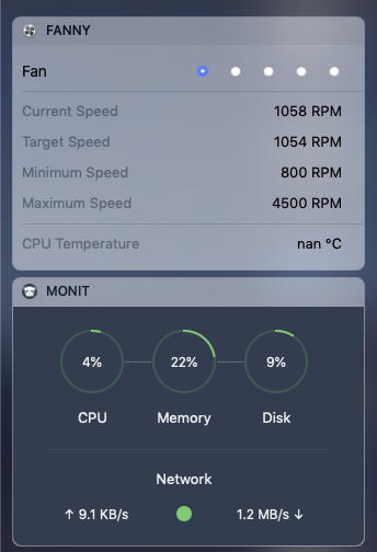

TinyWorkshop macrumors member Original poster Jul 30, 2018 #1 I've a problem with my Mac Pro 4.1 to 5,1 X5950 single cpu. I've tried different programs for monitoring the CPU temp but none of them seem able to see it. what to do?? 😵 anyway is strange because if I launch cineBench or other intensive apps the fans revs up correctly 😕

J JeffreyA macrumors member Jul 30, 2018 #3 I have this issue as well using certain hardware monitors, although it's a native 5,1. I think it's the software you are using. I can read the temperature in Windows.

TinyWorkshop macrumors member Original poster Jul 30, 2018 #6 hmmmm.... Macs fan control do the trick weird anyway PRAM end SMC already resetted.... well... I will stay with Macs fan control thank you guys! 🙂 Reactions: Alex Sanders74, JeffreyA and h9826790
