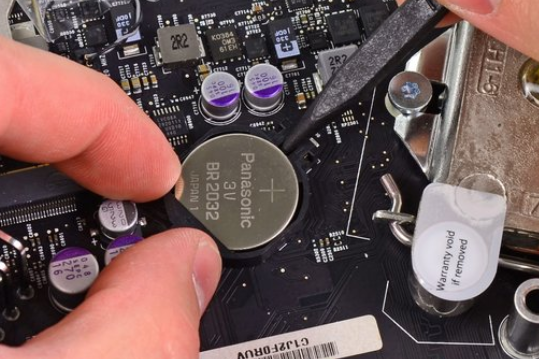

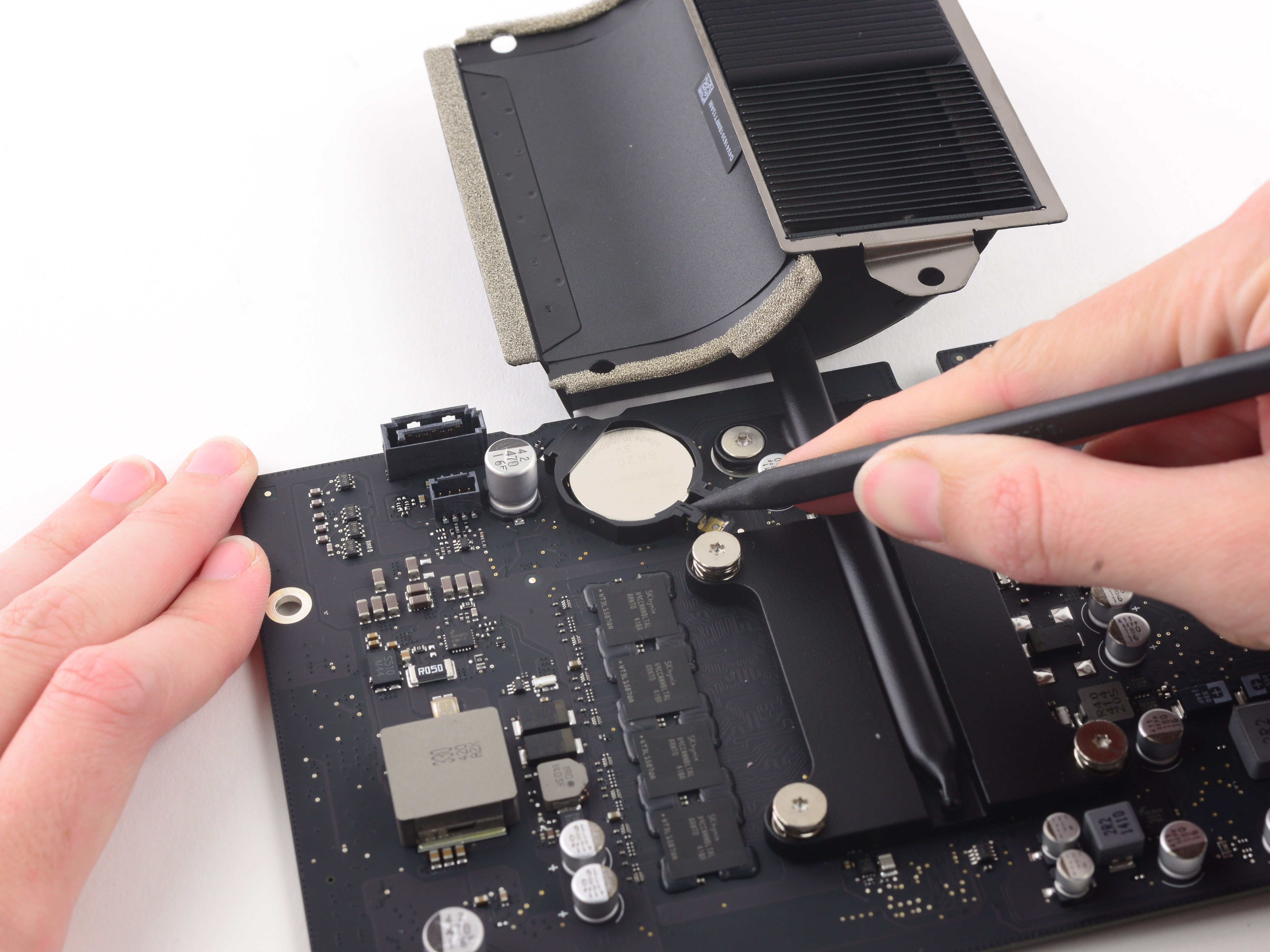

Reference Code: PFM006
If you are lucky you only have to change the little PRAM Battery........
If not ......
But it seems you have to literally detach every piece of the 2014 iMac....
Interesting. Correct me if I'm wrong, but to get to the battery to replace, I have basically tear the system all the way down and remove the logic board to get to it?
That is what iFixIt tells.... i do not have an iMac 2014 21....
