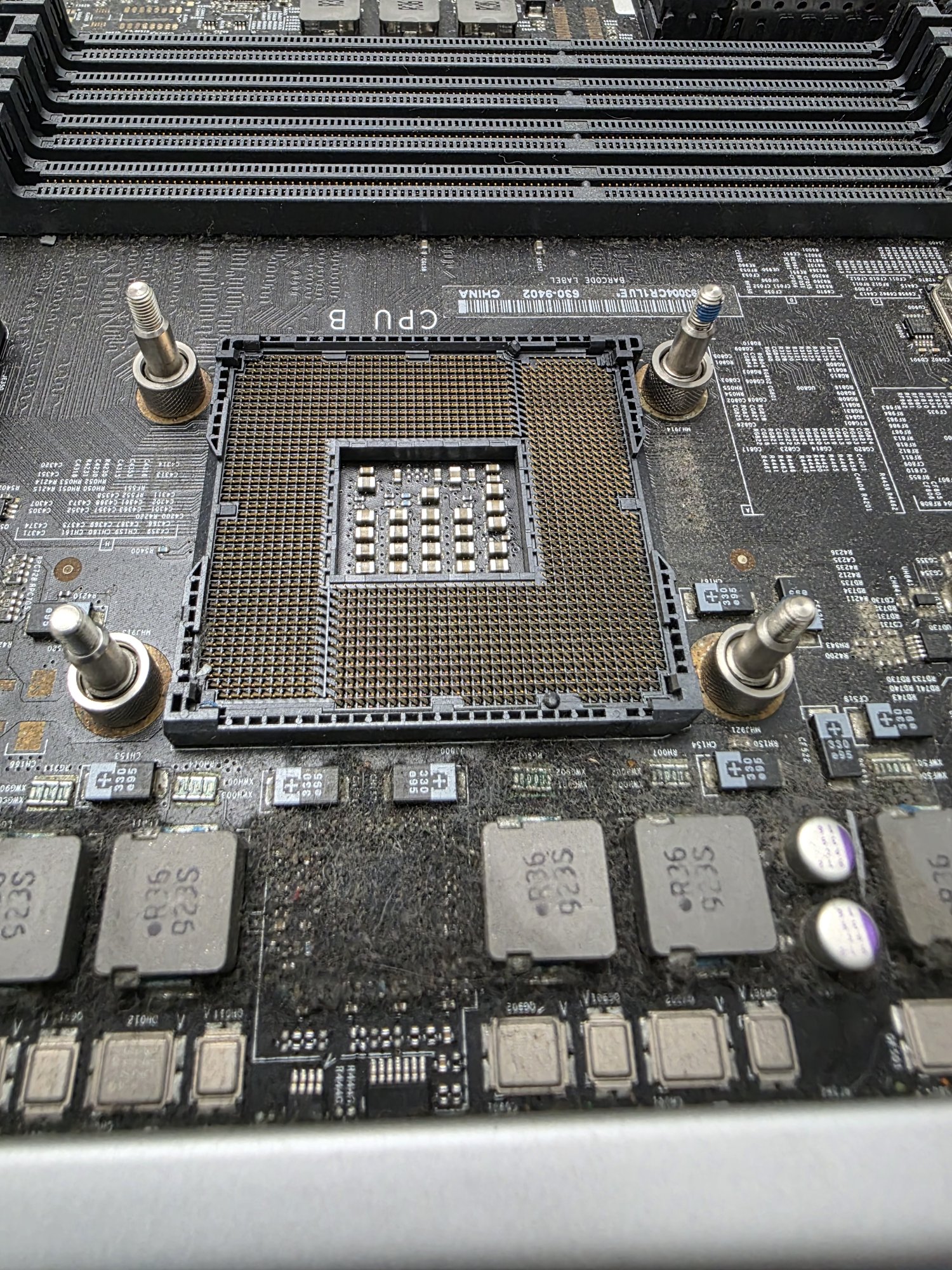

So I took it apart and it looks like the bottom of the CPU post have these circular spacers on them and they are loose (think they're meant to be like that) and they're making the rattling sound when I move the CPU Tray.
Does that mean the previous owner didn't tightening the heatsinks to the board tight enough??
I've attached a pic.....they didn't add washers, unsure if ir needs them now.

I picked up a 2009 Mac Pro with 2x 3.46Ghz 6-Core processors and when I removed the heatsinks (I could hear some rattling noise, when I took out the CPU Tray) I realized that the previous owner did not de-lid the processors or add washers & Thermal tape on order to use the lided CPU's.
So do I need to add washers & thermal tape or can I just put it back together.
Thank you for any response in advance.
My 2009 had been upgraded by the previous owner, and they used lidded CPUs. If memory serves, some hardware for delidded use was missing - I chose to upgrade further with lidded rather than revert to delidded.
It took spacer washers and thermal paste - I didn't use any tape. For a time afterwards, I had a RAM slot that didn't always register, which I attribute to the pins having been bent slightly by the previous work. I got my spacer washers even, so my heat sinks are definitely level.
It's worked reliably for years since, and the one RAM slot gradually became reliable again on its own. I'd definitely fuss about a loose rattle until it was fixed - rattling is not normal.
Imo lidded CPUs in a 2009 dual CPU board is no way good. And this is the diplomatic version…
Keep it as close as it was from factory and it works well. Delidd, polish the die. Keep the spacer, remove all remains of the silicon glue.
If I think of the voltage regulator circuits without proper contact to the heat sink, I wonder those machines survived.
Counting turns of the heat sink screws… oh my, oh my… and with luck almost all memory slots work, or not, or after turning the screws a bit. Or never, cause the processor pressure damaged the socket pins.
Its quite some work, to do it properly.
I remember it being a pain in the butt, and took several tries to dial in. But my factory spacers were missing, removed by the previous upgrader. So my options were limited.
