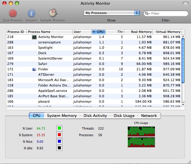

Can someone explain why my CPU usage is at nearly 100%? It just started doing this, and it doesn't appear to be caused by any processes that are running. I restarted as soon as I noticed it was happening. Didn't help at all.

Try "All Processes" at the top drop down menu, instead of "My Processes" to get a better idea of what is going on. It could be mdimport (but I think that is is user process), ATSServer, or WindowServer, those are just the ones that have given me trouble before.
Change the tab at the top of Activity Monitor to show "All Processes" and then sort by CPU. You're not looking at the whole picture.
Edit: Mernak types faster.
What revision of OS X are you on?
The three Intel Macs in our flat have had the issue crop up with 10.5.2. I just turned off Spotlight and it calmed them all down.
The process mdworker controls Spotlight. If that's going mental, you'll know about it.
I decided not to mess around with the config files, and instead just disable it for the drives through system profiler - add your hard drives in to it. It does disable Spotlight, but I never use it anyway. I know where everything is on my computers 😛
Thanks. It was some print manager thing. No idea why it suddenly started using 99.9% CPU.
