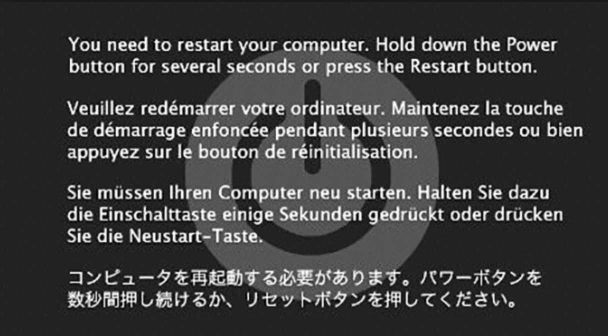

This is a kernel panic, isn't it?
100% CPU is not a kernel panic and its not indicative of a hardware failure. A KP crashes the computer freezing it, making the user force shut down the computer. You see this when you get a KP:
I understand that high CPU utilization is not a kernel panic. Most likely this is simply Chrome and Flash, but that isn't what I'm talking about.
Did you read what I quoted? Here, the OP posted this:
my pc crashes/shutsoff with a black screen that says: "an error has occurred" and restarts after 2 to 3 seconds.

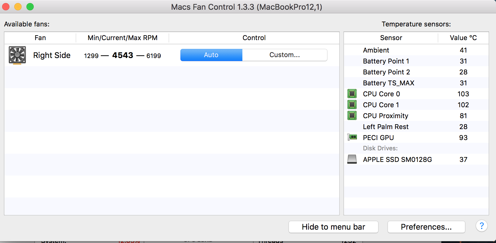

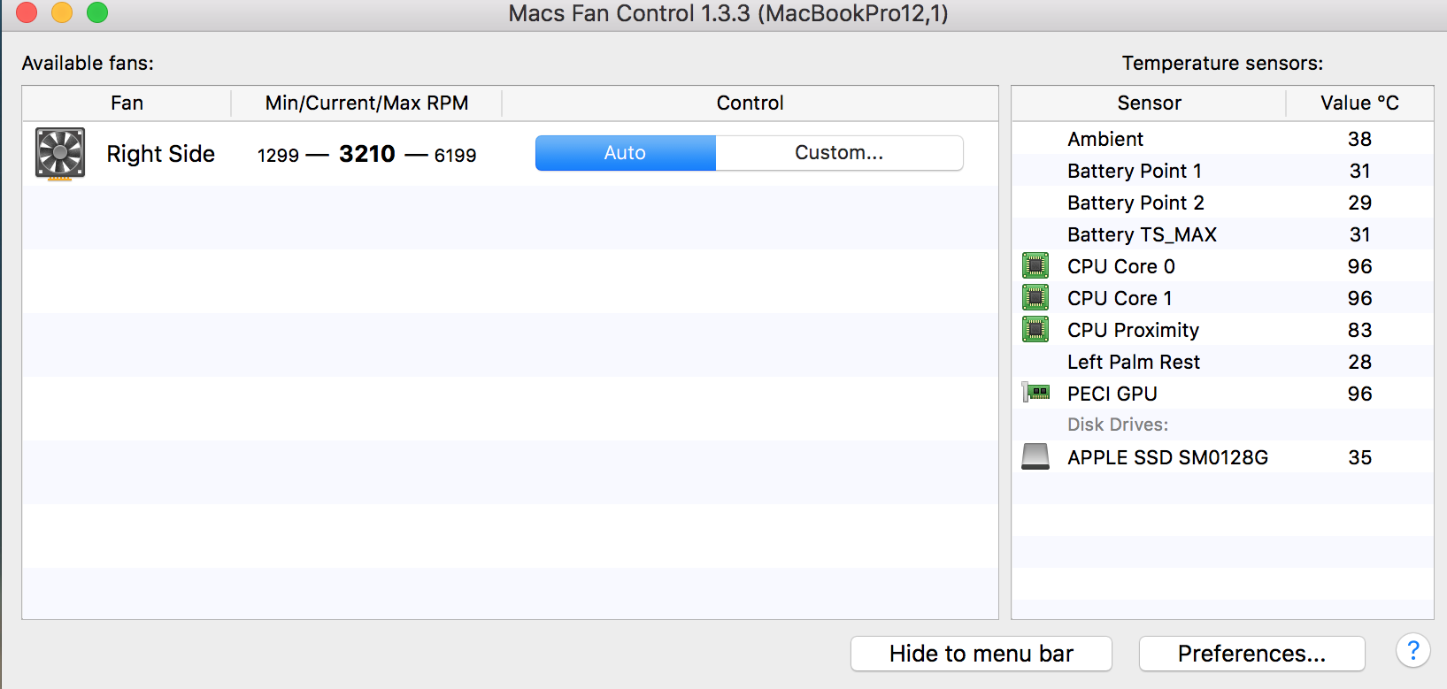

After watching a Twitch stream for 3 minutes i have gotten there results. I have not that much knowledge about these kind of things :S
Safari is enough improvement in CPU temp to let you know that Chrome continues to be a resource hog.
You are on the high edge of CPU use, so you might also consider not doing other tasks - no other apps open when you view your twitch TV stuff. (quit Steam (?) )
