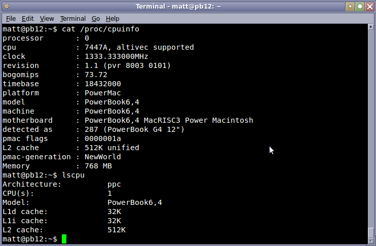

12" Powerbook G4

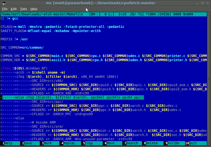

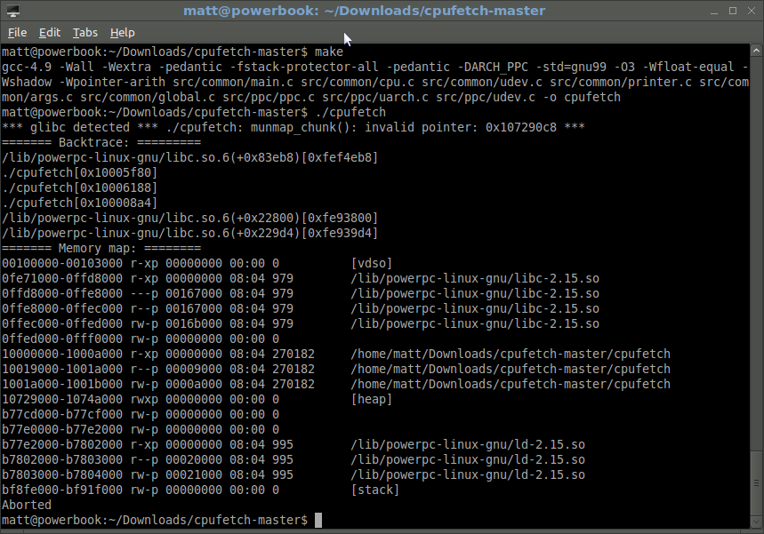

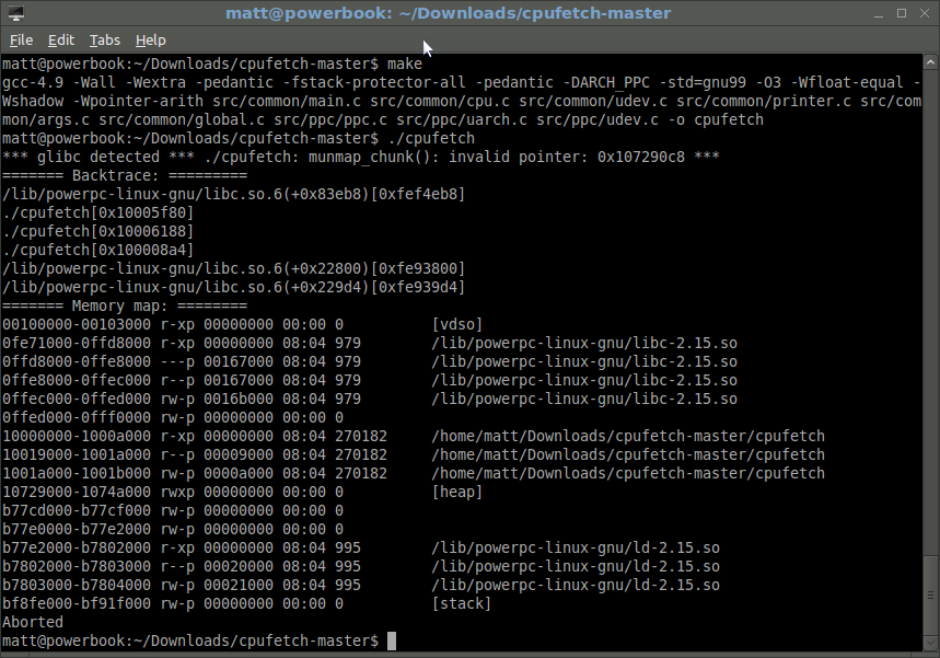

@ks23 : you may want to pass this along. In my quick look and testing of this i spotted 2 errors in the makefile that make it default to wanting to build for ARM, rather than PPC. He had used ppc32 rather than ppc64 and ppc, so it skipped ppc all together. Once i applied those changes it built, but it crashes. See attached.
Fixed makefile. See highlighted line.
Completed build, and crash.
Hope this helps.
Cheers
Hope this helps.
Cheers

Regarding the Makefile, I did a quick search in google and I used the arch that I found and also the arch that worked for the powerpc machine that I have access to (ppc64le). It's clear that the archs that I used are wrong because, as you said, in the case of your machine it skips the powerpc part and goes to ARM. Do you know an exhaustive list of powerpc archs that match all the powerpc architectures (both 32 and 64 bits)? Are we sure that "ppc64el ppc64le ppc64 ppc" includes all of them?
Right now, the powerpc port is in its infancy, so I expected some bugs in it. I'm pretty curious about the one you found. Can you please run cpufetch again with valgrind (that will tell you where did it crash)? If you are unable to use valgrind, you can run cpufetch with gdb, and it will also tell you where did it fail.
I prefer if you report this on the github page, but it's ok too if you continue the discussion here. Thanks!
No, i don't. I believe there is ppcspe also. I just included ppc64 and ppc as that covers 32bit macintosh G3/G4 and 64bit G5 machines (and i believe the amigaone x1000/x5000 as well) that most of us here use and or have access to.

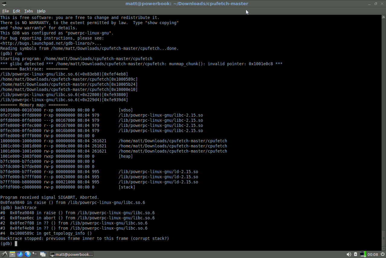

As for running gdb on it, it produced the exact same output as the screenshot above. Running ./cpufetch --help does work/display properly however.
On a side note: I am not running recent linux distro's on these machines. I'm mainly using my own custom variants of ubuntu 10 and 12. Not sure if that will have any adverse effect in testing this. At any rate, removing ppc32 (it's not a thing, just slang people use to specify 32bit) and adding ppc64 and ppc was enough to get it building.
Hopefully others will chime in with more knowledge. I just spotted that in the makefile and wanted to point it out. Best of luck in your quest to add more powerpc support. I'll keep an eye on this thread/github, but honestly i'm too busy with multiple other projects to add another to my list to participate in.

Thanks for the tips. I have updated the Makefile to include your corrections.
I'm sorry to bother you but I forgot to mention that to get valid results with gdb/valgrind, you need to compile with debug symbols. In cpufetch this can be done using "make debug". The fact that you have old and/or custom Linux distributions make it easier to break things in cpufetch but that is precisely why I'm really interested in understanding what's going on in your machine.
If you don't mind, please download the program again (git pull will suffice), compile with debug flags (make debug), and let's see if gdb now tells what happened. When the program crashes with gdb, you can use "backtrace" to print the trace of the program. If gdb does not help, I would suggest using valgrind as it provides better information in this kind of situations. Thanks!
@Dr-Noob : Ok built with make debug. Output still looks the same, so then i ran backtrace. Here's the output.
I don't want you to go down a rabbit hole on this. Someone with at least Ubuntu 16, Debian 10, Void, etc should be trying this instead of me and my "outdated" OS's. I'll try to put my G5 back together and see if i have better luck as i have a current Void install on that.
Cheers
Cheers
Thanks @wicknix. I'll wait until we have a more solid clue of what's wrong. Unfortunately, I only have access to a POWER9 CPU running one of the latest Fedora releases, so I can not reproduce this issue.
