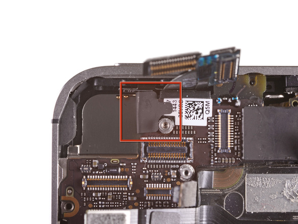

Couple of things to be careful with the iPhone 4. Be very careful when disconnecting ribbons off the logic board. If disconnecting with plastic spudger, don't take them off by leveraging against the logic board, there are quite a few little jumpers that can easily break off, and you can find yourself with the camera not working after a jumper is broken.
Also, when inserting cables from the new screen, you have to really make sure both digitizer and LCD cables get fully inserted and are equal length in. Lot's of DIY'ers get one of the cables crimped up.
Don't over-tight screws, especially 6 screws holding digitizer/LCD along the sides, as that can cause some distortion in the LCD.
Take your time and be gentle. Don't force anything. Don't forget to take the SIM card tray out and start yanking on the logic board to come out.
You can remove mesh from old one. PITA not to have that on the new screen though. You may need some adhesive to keep it there after peeling off the old one.

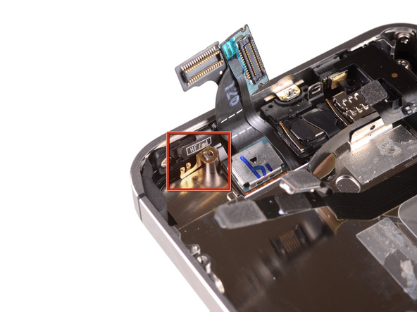

4s is very similar, just a couple more little shields. Be a bit more gentle on one of the early steps removing the battery connector. They seem not to be soldered on as well as the 4 and if pulled to hard, can yank it off the logic board and you're screwed. Not to worry, just be gentle, don't do a "hard flick" motion, but a gentle lift. Always kind of use your thumb or other hand as kind of a "door stop" to your motion so you can't go too far with a movement, if you know what I mean. When you're doing an action, you don't want a scenario where it suddenly "gives" and your momentum causes a big movement and something tears. (Causing another big movement) 🙂
Taking cables off the logic board, you can use spudger, just be careful to just get under the cable, don't use the logic board as leverage. If you have a good thumbnail, you can use that as well which is sometimes easier to be careful.
If the cable gets crimped, it just won't be long enough to plug into the board, but if you screw on the LCD / Digitizer with it crimped, you can easily damage the cable.
There are one or two little plastic pieces that might come off that need to go back on. The main one that happens is a little protective piece of plastic that sits on the logic board at the top and protects the LCD/Digitizer cable from rubbing against the logic board. In the photo below, its hard to see, but it's sitting right at the edge of the logic board, right on top of the white barcode. Little piece protects LCD and digitizer cable as it wraps around and connects to logic board. Falls out a lot as your taking out.
