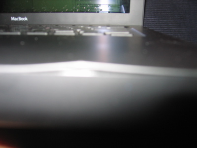

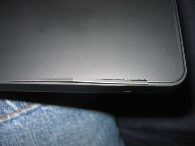

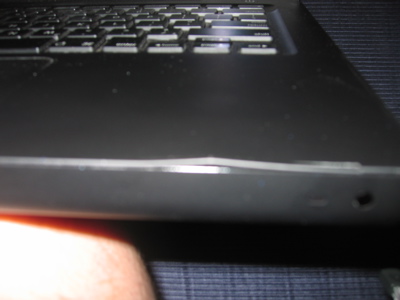

OK, so tonight I was playing Civ IV on my Black Macbook C2D and I raised my palm off of the palm rest and part of the case came up with it....😡
Do you think that Apple will cover this, or do you think they will say it is from user neglect or whatever...I haven't dropped it or mistreated it in any way...it did get pretty warm under there while I was playing the game, but it does when I am working on a chapter in my thesis too...what do you guys think?😕

i think they might replace it. i think there have been problems with the magnetic latch causing the case to crack in the same area that you describe.
do a search about the macbook magnetic latch.
there might have been a problem that you never knew about
I think it is a bit to the right of the magnetic latch...but maybe its bigger then I thought it was...

I have the exact same crack on my MacBook, but I haven't taken it in yet. I'm waiting for more problems, I guess -- I also have a flickering screen, hairline cracks around the outside of the lower shell, defective power cord, intermittent battery problems, etc. There's just a crack, though -- the part hasn't fractured enough to actually come loose.
Just go ahead and call Apple. When I owned my Blackbook, I had this exact same problem. Like others have already said, it's caused by the magnetic latches and the rubber stoppers on the screen cracking the topcase.
I called AppleCare when the problem arose, and they immediately covered it under warranty, no questions asked. I received the shipping box the next day, and then I had my Blackbook back two days later, with a brand new topcase. They even replaced the trackpad and keyboard! That is what great service is!

Just to add another conformation to this, took my white macbook Core Duo in for exactly the same problem and the Genius behind the bar told me flat out it's "a design fault". The part of the case the stops come down on when the lid is closed doesn't actually have anything underneath it and, over time, it tends to get small hairline cracks. At some point it WILL break.
As far as I know there is currently no modification by Apple to actually fix the problem. On the upside you get a new top case, keyboard and trackpad when they fix it. Not much of an upside I grant you but still...

Most people who have reported this problem, haven't generally added which revision their machine was - although, I'm pretty sure that most of the ones who did were using the orginal models. The problem was largely flagged towards the end of 2006, although people (like the OP) are still reporting it. Given that Apple hasn't acknowledged this (or as far as I'm aware) and that sites like Macintouch and Macfixit haven't been inundated with reports from readers, I'd guess that this isn't a widespread problem... not that, that's much consolation to those who have been affected.
No one seems to know what's causing the problem - a design flaw seems a popular choice. Although, I think stress fractures caused by the plastic moulding process is a likely culprit. If it is, Apple's not the only manufacturer to have problems with it by any means.

OK, folks, I just took this to my local (if you call an hour and half drive local😀 ) Apple Store and they are going to fix it for me. He did say it was cosmetic and that he shouldn't fix it, but he was going too. They had to order the part, so I am going to take it back in when he calls and lets me know the part is in. He ordered it this morning. Anyway, I have been to this store several times and they are always good to me, but he did say that he shouldn't cover it because it was cosmetic....
Anyway, I am pleased though because it is getting fixed and I didn't even have to say anything. I just pulled out my computer and opened it...😀 :apple:
