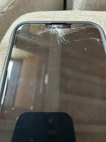

Can anybody help identify if I have just cracked my screen or just the screen protector? I am traveling, so there is no repair shop nearby and I don’t want to takeoff the screen protector in case it falls again. And LOL just like the other poster earlier my wife dropped my phone 🙂

It looks like the damage extends into the notch area where there is no screen protector so it appears your screen is toast

Your screen is cracked, sorry. It must have been dropped on something protruding off the ground which is very unlucky seeing as you have good all round protection with the case and screen protector.
Ok my Face ID works fine and I’m able to pull down from top of the screen to show the clock so that means my touch display doesn’t need replacement and only the glass does. I’ll probably go with an aftermarket cheap glass replacement and then do site it. Spending 329 on a 2yr phone may not be wise

It’s a full module, if you change the screen you’ll have to change everything in it as far as I know.

There are shops that have the equipment to be able to separate the top glass from the OLED panel. They then attached a new glass on the old panel.

I know that it is possible however it’s rare to see anyone carry out such a job as it is time consuming to transplant the components from one screen to another, almost every repair shop will give you an option of OEM or non OEM replacement parts and will remove and replace the screen in its entirety.
Screen protectors won't prevent a screen from cracking or shattering upon impact. They will however prevent scratches and hold a screen together in the event it shatters or cracks.

So you mean they will want to replace the whole display and glass?
Yes. It’s a screen replacement and that includes all the components. 99% of all cracked screens are just the protective glass however the entire screen and components are almost always replaced as they are soldered onto the backboard.
The entire screen replacement is modular so you have to pay for everything.
The idea you can remove components and transplant them is pretty much unheard of. It’s possible but requires a lot of expertise and is very time consuming. I have never seen a repair shop offer this service. You will have to choose between an OEM or non-OEM replacement which is usually around $100 less however will be noticeably cheaper and may not even be an OLED screen. You’ll also receive an annoying message in your settings stating that your phone has non-original parts which will severely affect the second hand value of your phone if it is ever sold.
I know you don’t want to pay $329 however having Apple carry out the repair is probably the best option.
Stores with equipment and skilled technicians will replace the cover glass. It's a pretty simple procedure and you get to keep the original high quality display module.
Small repair shops will replace the entire display module - not preferred, but it's easier and fast.
It really comes down to where you live and the availability of service.
