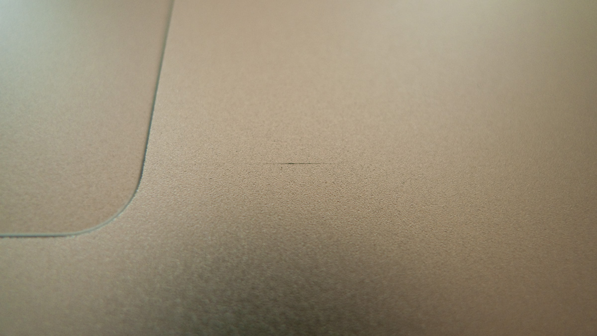

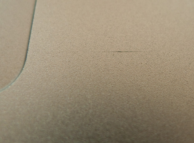

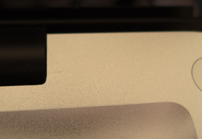

I just got a MBP Unibody 13" 2 days ago. I noticed a hairline crack on the right hinge part of the casing (near the power button) when I first opened it.
I was debating taking it back under the 30 day no questions asked policy.
Today I opened up my laptop and noticed another crack which was not there yesterday. The new crack is to the right of the trackpad.
Here is the new crack:
And the first crack - by the hinge:

It might look like the crack in the image is raised or a scratch but looking closely it is clear it is a crack it is even wider in the center and narrow on either end.
Anyway to me this is a little worrying - I wouldn't expect to be seeing stress fractures so quickly.
Maybe this could be because it is a very recent batch?
