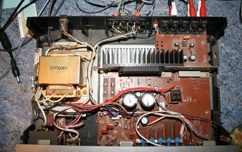

In utter theory (as this amp is as old as the hills), what causes an amplifier to constantly "crackle"?
Mine started playing up just a few days ago. Totally out of the blue too. I've tested it by wiring up 1 speaker and opening the thing and fiddling about but I can't see anything wrong.
I can't have this amp die on me 🙁

It's a constant crackle even when the volume is turned to 0. same on both speakers. no affect when add inputs. When I tested it I just had the power cable and 1 speaker plugged in.
What sort of amp? hmm. some retro 70's hifi amp. *pic attached

OH! If its of any help, it always gets *extremely* poppy when the Phono input is selected. The popping and crap noises actually do get louder as the volume increases when I select that.

Well, the Phono input is the input with the most gain... circumstantial evidence that the problem is upstream of the preamp... Still wouldn't hurt to get a can of contact cleaner spray that is specifically for potentiometers and switches, and having a go at everthing that the audio passes through - the source select switch becoming the primary target here, perhaps. That's a $10 investment, whereas it'll be a minimum $60 or more at the shop.
Alright, thanks guys. Off to buy some cleaning stuff now. In the mean time I'm using an Awia amp from around the same time, half as good and twice as big... urgh.

Worked a treat! Totally opened her up, covered the whole thing in electronics cleaner, was soaked. Worked my way into the nooks and crannies with a little cloth/screwdriver. Though whilst in there I noticed one of the 4 fuses wasn't fully connected, stuck that back in place. Not sure exactly what fixed it. But I did remove 30 years of dust (pops never opened this thing).
Infact, it's making less standby buzzing too.
INFACT. Safari feels faster.
The volume knob is noticably stiffer too 😀 really!

It's broke again. GRR! just the left speaker giving off an occasional hiss. Much better than before (constant) but still annoying. My guess is just do more of what I did before? *sigh*
