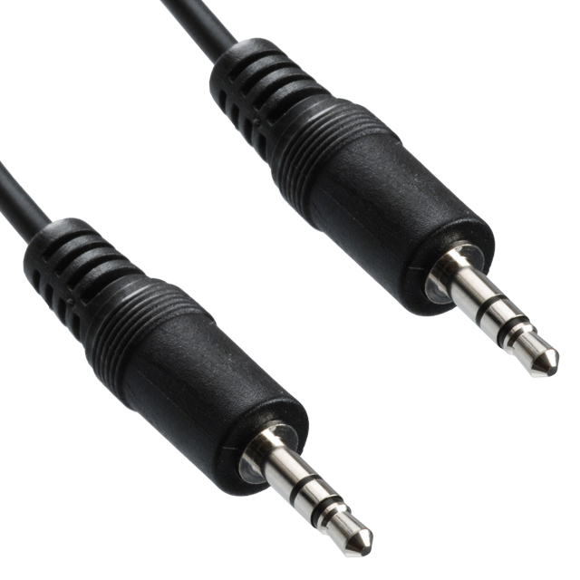

I always had problems if I used a cable where the back of the connector could touch the metal of the G5.
These would pose a static problem due to the metal on the base of the connector making a connection.

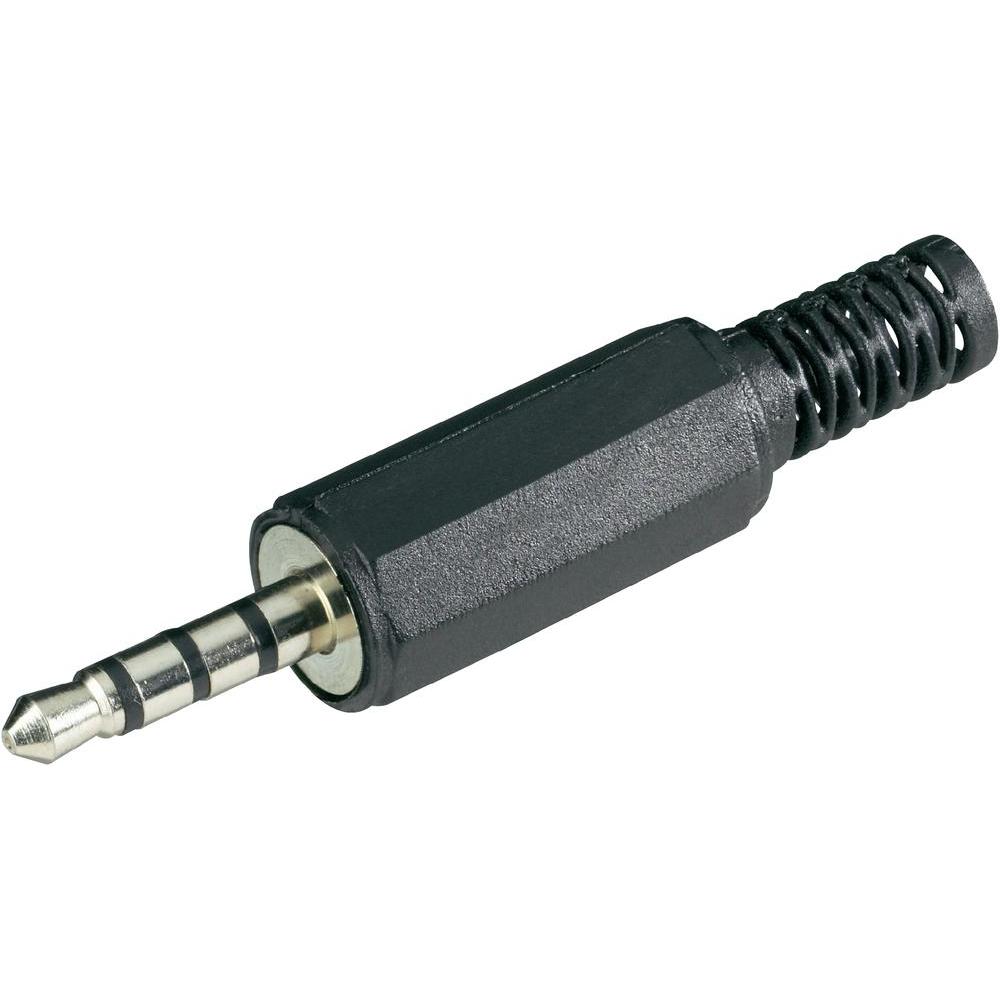

These tend to work fine in my experience:
These would pose a static problem due to the metal on the base of the connector making a connection. Image
These tend to work fine in my experience: Image
Hmm, that seems to be the source of the issue. I will have to try covering that somehow or buying another aux cable. Thanks!
