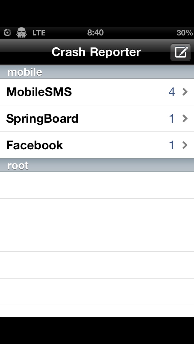

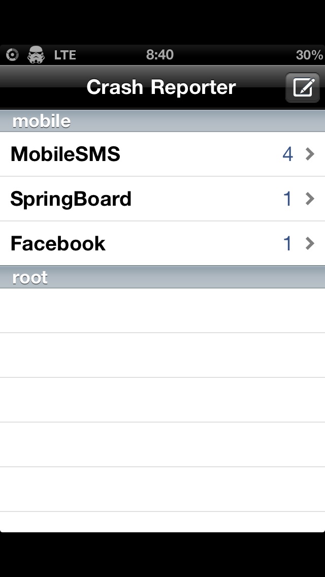

My springboard crashed today and I'm trying to figure out what was the reason. I was on Facebook and phone crashed. How do I read it? My ram was around 85% used at the time.
Man I wish I knew how to decipher those. I think you need to have an understanding of debugging to figure it out. I've spent many hours googling this topic and never really got anywhere.
When you tap on Facebook, does crash reporter list any "suspects"? Usually if it can give you that information, sometimes that points you in the right direction. But I've had times when it said one thing was the main suspect but it ended up being something completely different. I stopped using crash reporter unless a dev asks me for a log. Now I do it the manual way...disable tweaks one at a time to find the problem. Sometimes though, apps from the App Store have crashing issues. Not sure if Facebook is one of them though. I don't use Facebook.

For the Facebook one it doesn't have any culprits for suspected crashes. So I'm not sure.
