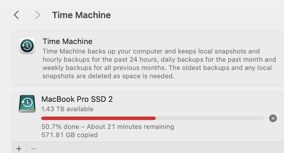

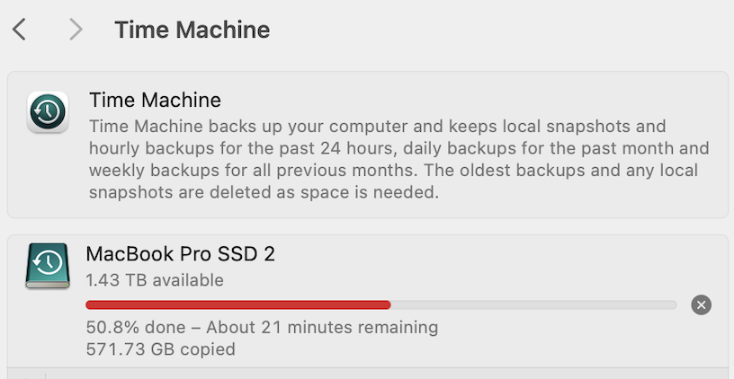

OK, I did a backup twice, with a newly erased SSD disk. the first crashed at 3:37 PM local time. The second died at 7:01 PM local time. Both times, the disk was erased and empty, and just added as a TM disk to use. I did screen caps both times, it progresses quickly (roughly half done), then crashes around the identical place - it pauses at this point for about 5 seconds, then ends - as if no backup was done. The crash I show above is then in the log.
Here are the views of the progress.
The first crash at 3:37 PM:
And here is the 7:01 PM crash:
Nearly identical!

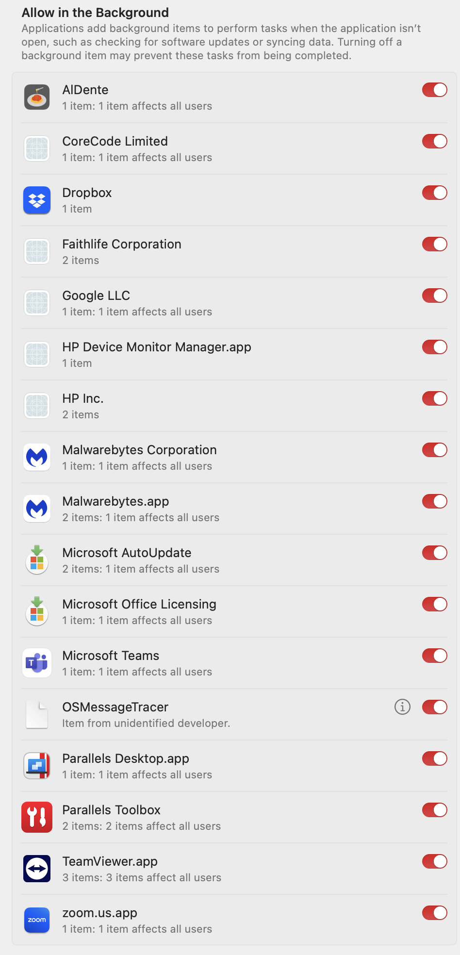

Your Open at Login and Allow in the Background numbers sound high to me (I have 1 each on a 2023 MBP, both for BlockBlock). You appear to have ruled those out, but maybe if you post a screenshot of the Login items screen it will ring a bell for someone.

And here is the Allow in Background List, in case someone sees something else that could be an issue:

@Grumpus I re-disabled all the Open at Login and Allow in Background, plus turned off all the Extensions in Privacy & Security/Privacy, restarted, and it still crashed ☹️
