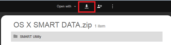

First thing to try would be to check the HDD is OK. Download SMART Utility, extract and then run it - anything other than 'Passed' means your hard-drive is corrupted. As you're running Lion I've attached a Google Drive link for an earlier version of SMART Utility that will work on your OS.
Click the download icon at the top to download this (highlighted below in red).
If that passes, try verify the volume in Disk Utility. Does that come back clean?

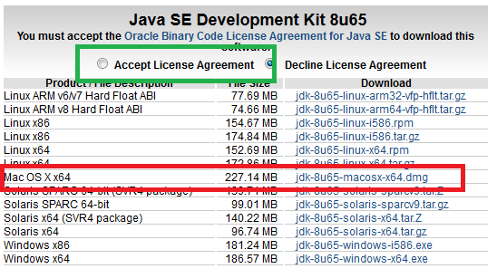

Just to also advise that it looks like it's crashing when using Java. Providing no problems were identified in the above troubleshooting steps, try download the latest version of Java here and then click 'Accept Licence Agreement' (highlighted in green) and then download the Mac OS one as highlighted in red.
Also try download this version of Java to see if this makes a positive impact.
Then restart the computer with 'Reopen windows when logging back in' disabled. Does this fix the issue?
Passed SMART, Passed verify. Downloaded and installed 8U65 JRE & JDK. Still the same issues. I'm starting to get beach balls when opening Word, and when clicking on the applications icon.
