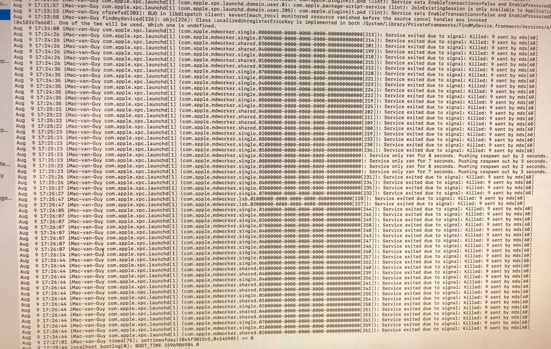

I need some advice on a 2010 21,5" imac that has some stange behavior
I can run the mac for hours doing light work, but when i play a youtube movie or some other harder work it crashes, and when trying to restart it stops halfway true the progress bar. Booting in safe mode keeps working
I installed fan control software and I can see the problem starts when gpu temperatures go above 60°C
I already tried cleaning the fans, reinstalling the OS, installing on external Hd to check it isn't the hd, but the propblem keeps comming back
Is the graphics card broken? when i use the fan control software speeding up te fans to keep the imac cooler it keeps working! but 60° is in my mind not hot enough to crash the imac and when working the graphic cards works perfectly
Strangely when going in the log, the startup freezes on a lot of the following errors:
com.apple.mdworker.single. #number# : service exited due to signal killed: 9 sent by mds (60)
any advice please?
Thank you in advance
