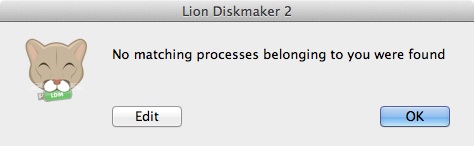

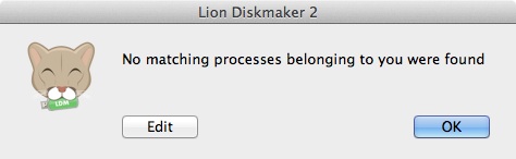

Lion diskmaker error message
I used the Lion Diskmaker program to make a bootable usb key of both Lion & Mountain Lion on 2 different computers. In both instances I received an error at the end.
Doesn't seem to have affected the keys as they both booted and worked fine.
