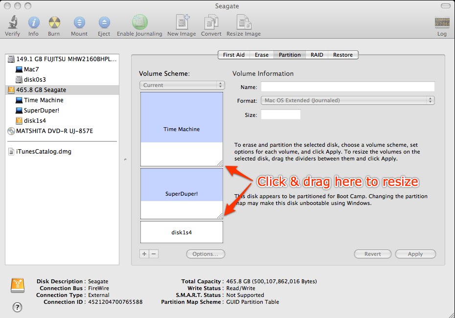

Leopard supports repartitioning on-the-fly in Disk Utility. No worries!

What worked for me is when I resized my external, the first volume as the TM volume (as it had been originally) and was left with the same name. The added volumes were named to something else.
I think it's more of a matter of the TM app looking at Disk x / Volume y consistently. If you created new volumes on the disk, as long as TM was looking at the same volume, you should be fine.

I think I get what you're saying, resize to as small as you can, "leapfrog" the files over to the new partition, then resize again until things are where you'd want 'em. That should work, but keep in mind, the first partitioning of the drive is destructive. I've actually been talking about this on another thread. iPartition allows for nondestructive partitioning.
