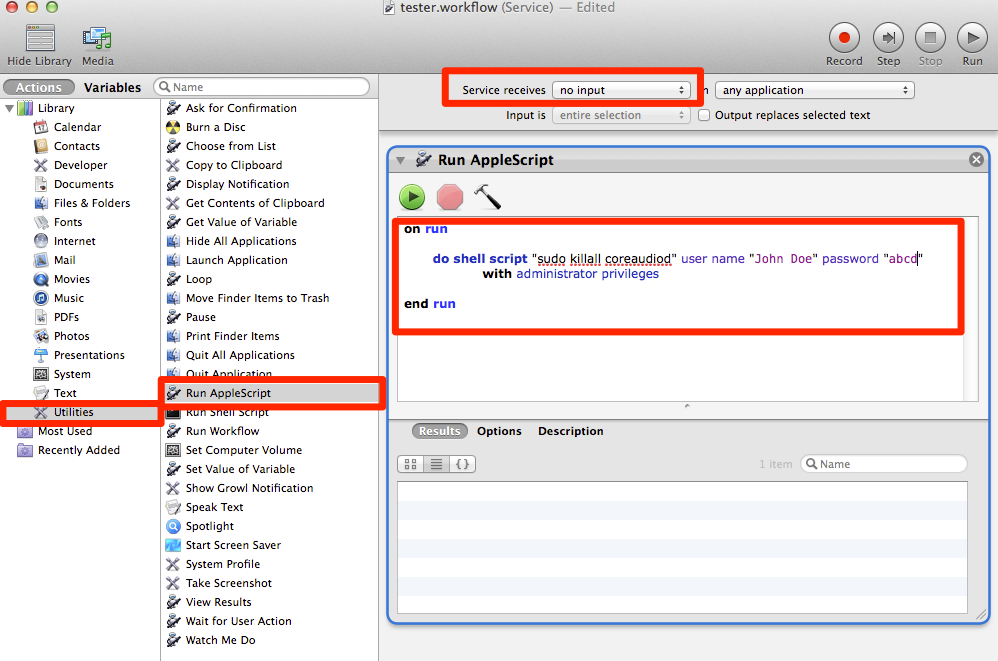

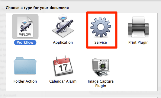

launch automator, choose service from the options
select 'utilities'
drag 'run applescript' into the main window
set 'service receives' to 'no input'
in the run applescript dialog enter the following text:
Code:
on run
	do shell script "sudo killall coreaudiod" user name "John Doe" password "abcd" with administrator privileges
end run
replace John Doe with user account name and replace abcd with the users password
alternately you could use
Code:
on run
	do shell script "sudo killall coreaudiod" with administrator privileges
end run
though in that case you'll be prompted for password every time you call the service
select 'utilities'
Code:
on run
end run
Code:
on run
end run
