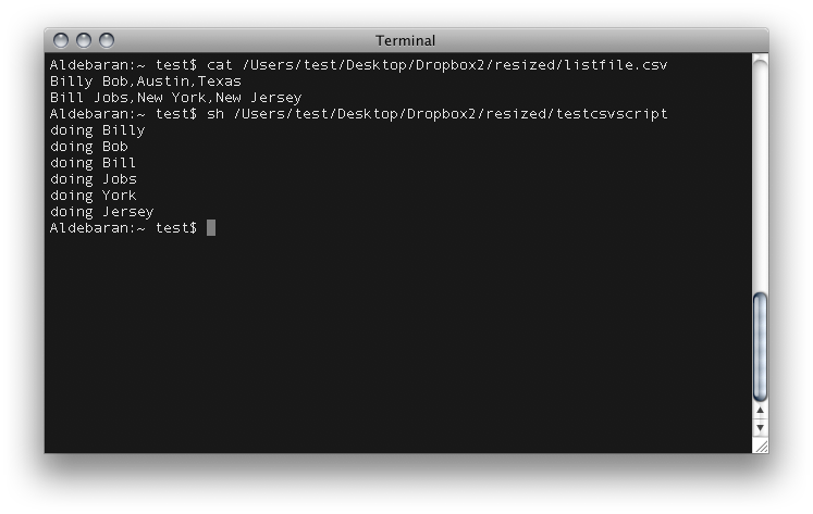

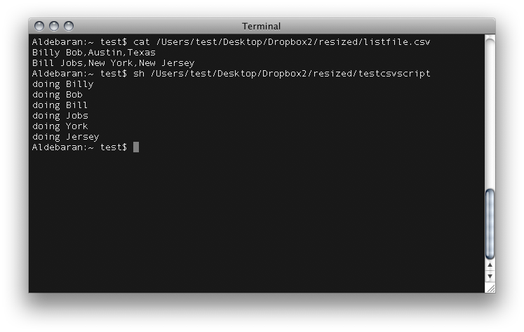

There's a bug in the code.
I was waiting for someone to catch that. It also doesn't handle spaces. Mac_Max's Obligatory Perl implementation creates csv files instead of txt files. (at least it did when I tested it) When fixed it's very fast. I wish I knew Perl.
