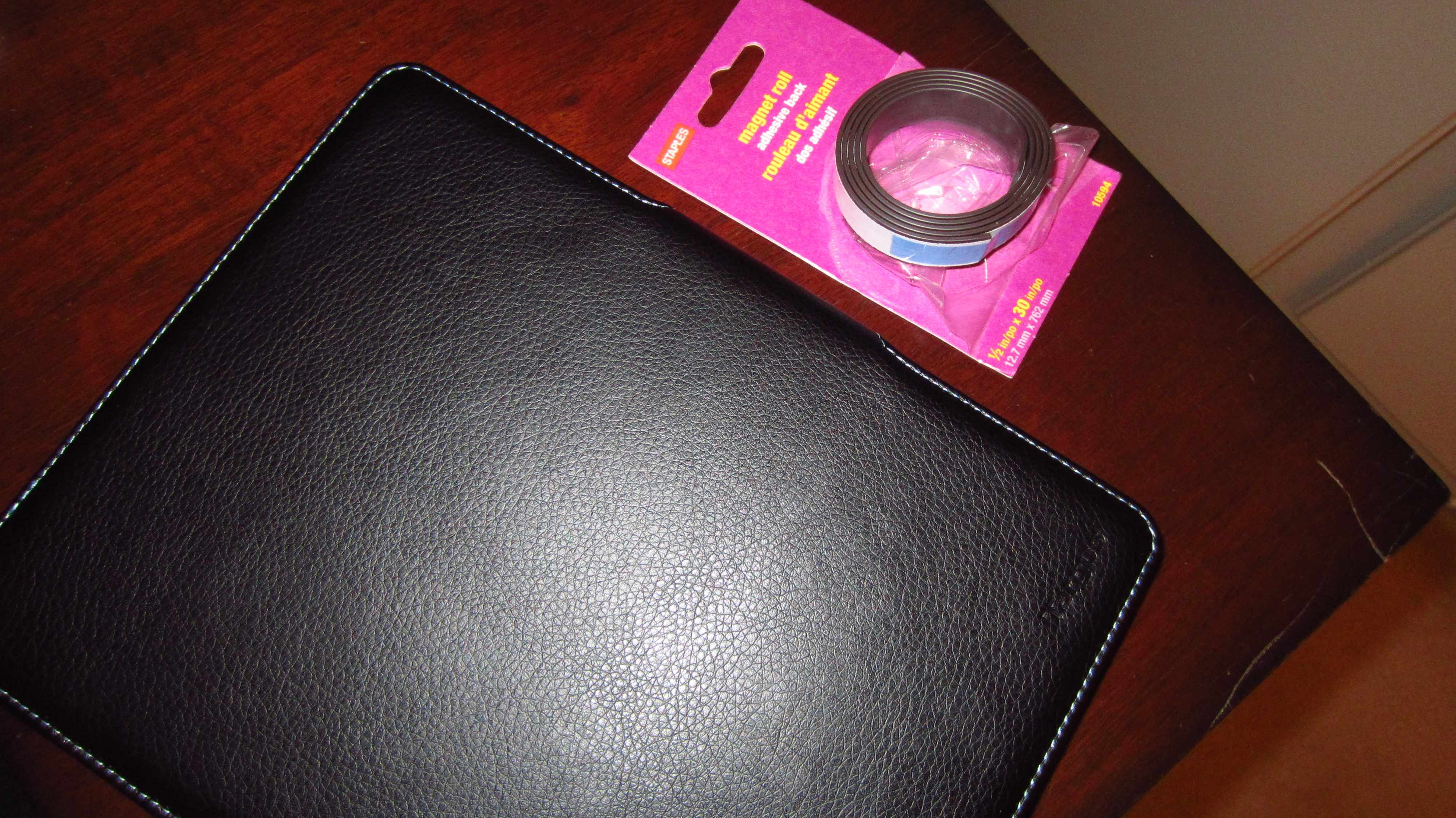

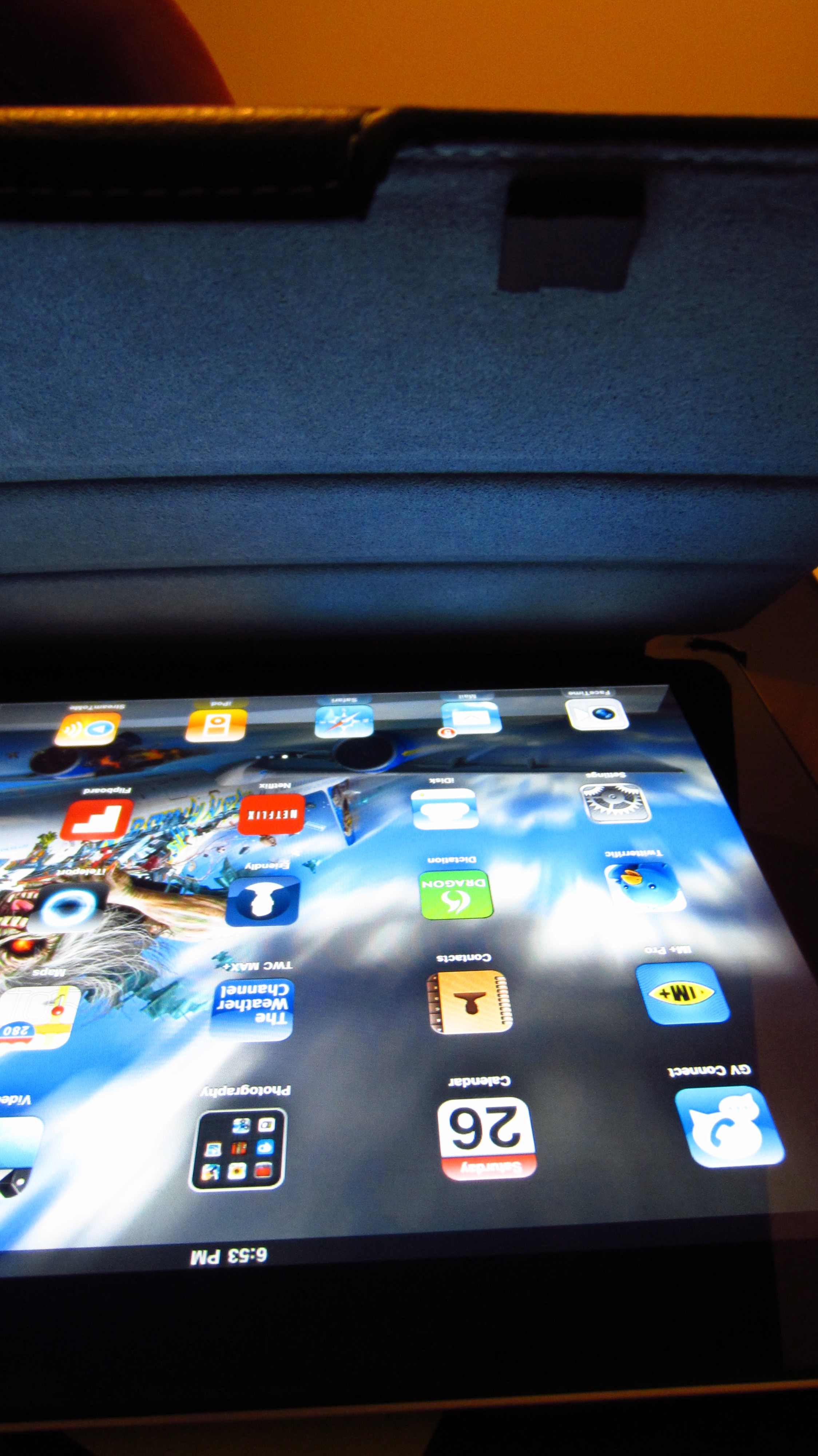

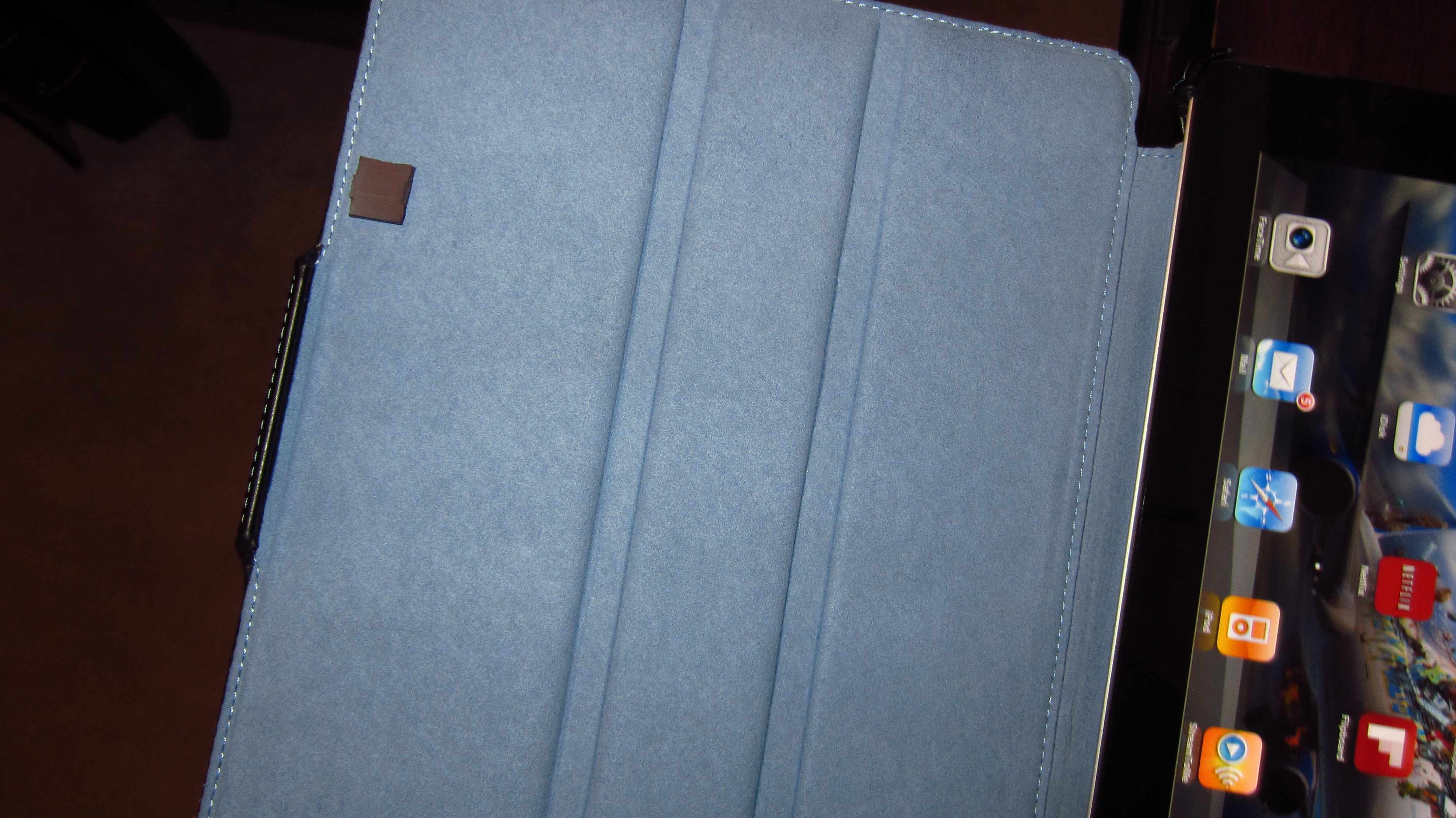

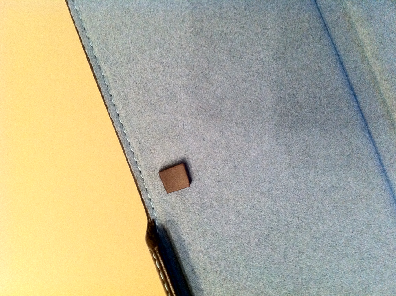

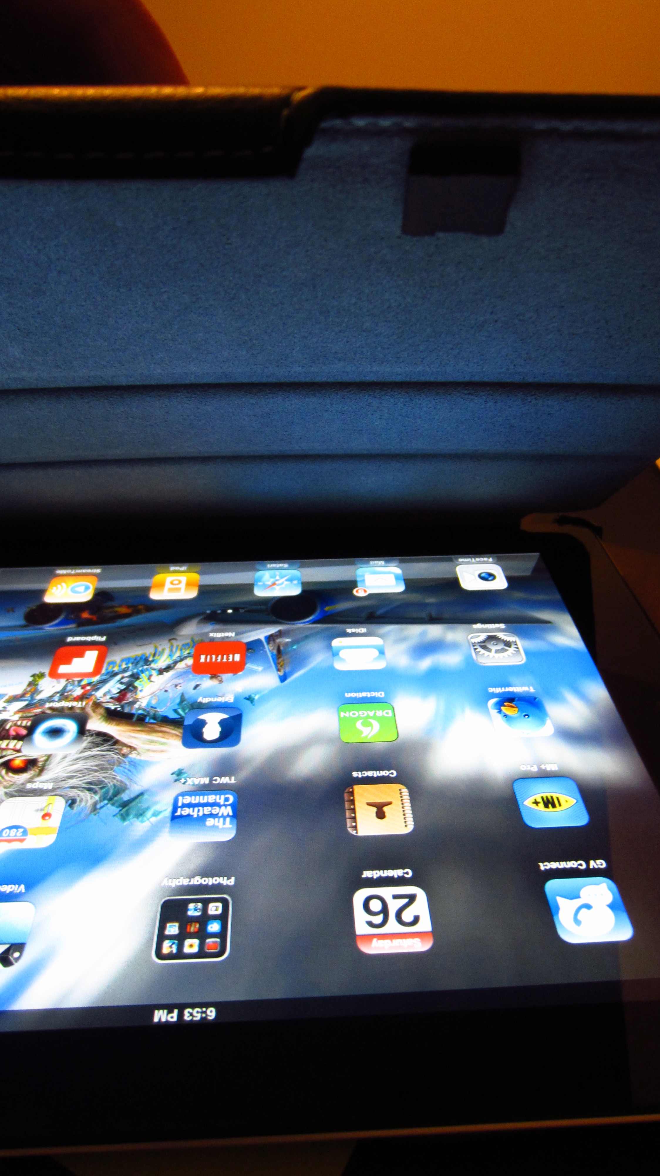

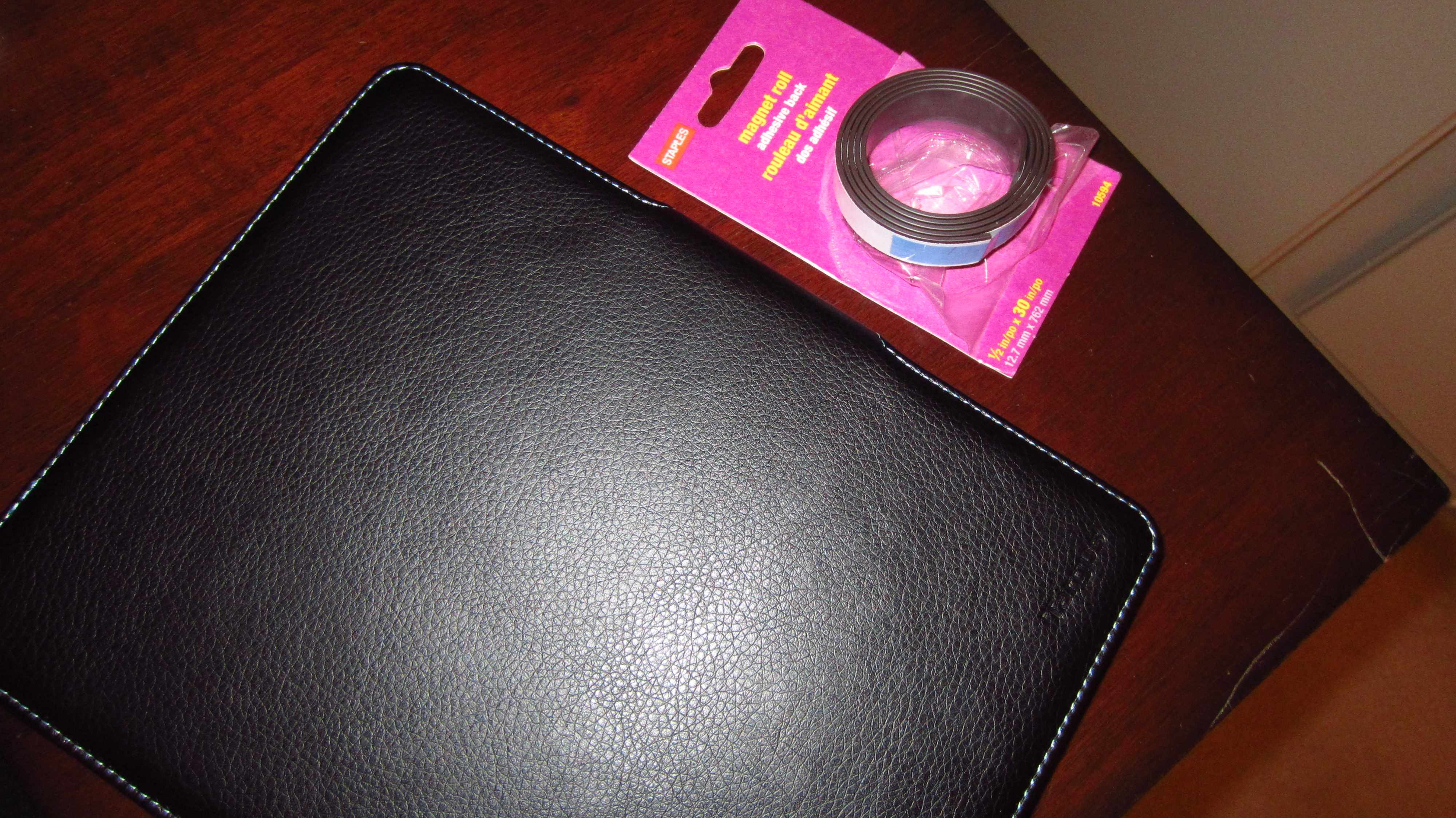

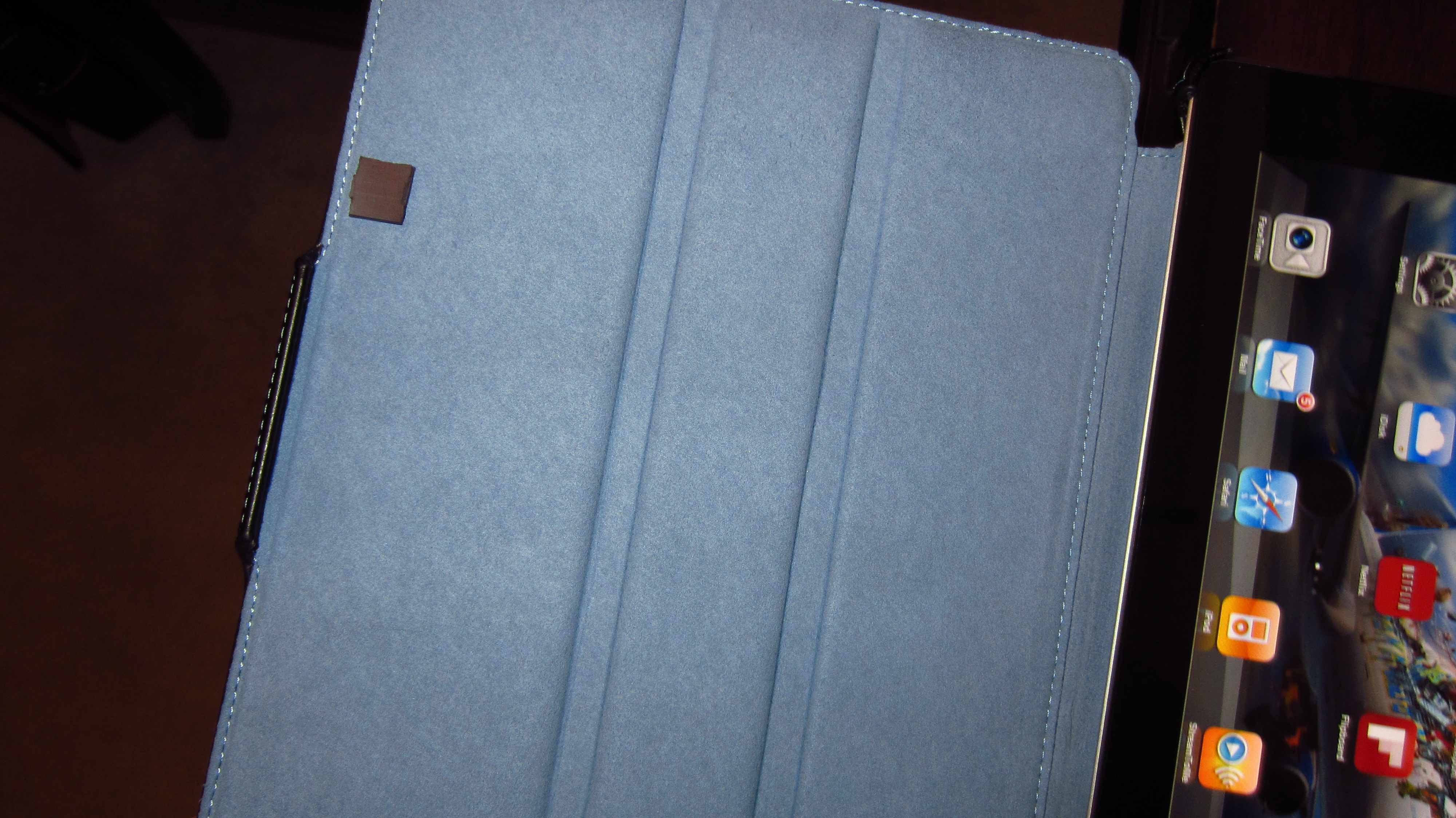

I'm constantly searching for a case that best suits what I want. Found it, (the Vaja one) but it'll take 35+ days to get to me. So, I decided to stick with the Targus Vuscape in the meantime because it's similar. I liked the Smart Cover, but didn't like that it didn't have much protection. But what I did like was the instant on and off. So, I ran over to my local Staples and bought a magnetic roll with adhesive back for $5, broke two pieces off, stacked them and stuck them on the inside of my Targus case cover. It worked perfectly! I'm sure you can do this wish any case. I have an SGP screen protector on, and the magnets are soft, so I'm not worried about scratching my screen. See attached pictures.

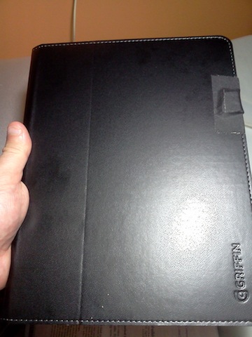

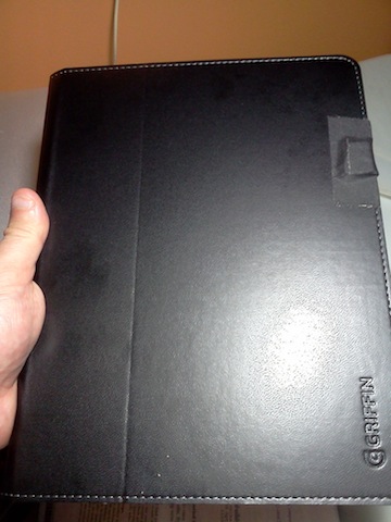

I used BestBuy's Griffin case and half of magnet from one of those refrigirator magnets. It works good but not thin enough so i had to keep it outside secured via gaffer tape. I might try your idea. If ipad doesn't have screen protector will this tape scratch it?
The magnets are soft, I don't think they'd scratch, but I always use SGP or Powersupport screen protectors to keep my iPad perfect for better resale value next year.

The problem in (for my case) if I cut it open it'd still have to be thick, that's why I had to double up the magnet. I'm sure there are workarounds for either method. Maybe even cut a little hole, stuff it in there and then sew it back up.

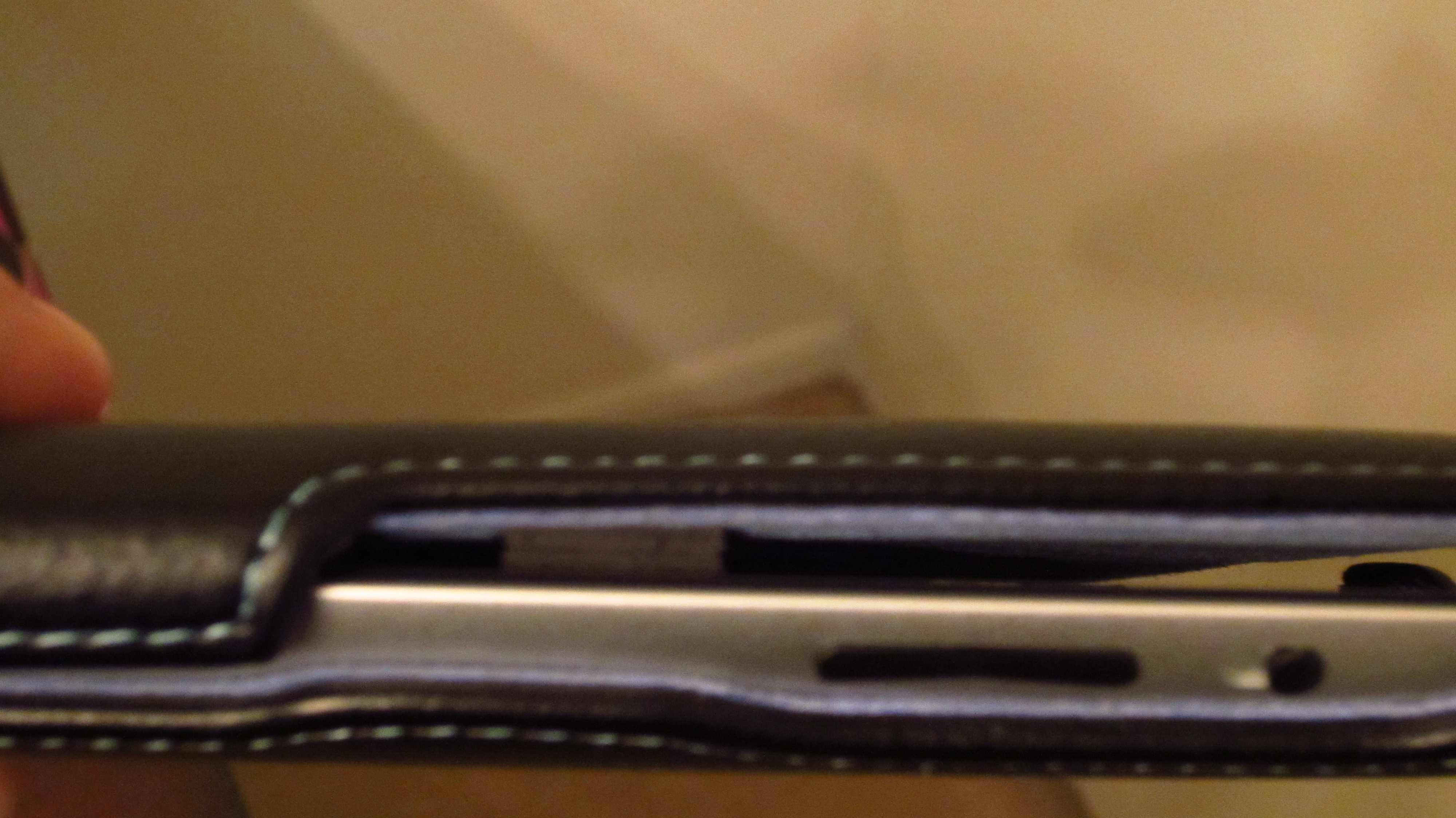

I did think about it, but don't want to ruin the case. I'm not a very good seamstress 🙂 I ordered a Vaja, and I'll prob sell the Targus in a month or so. Also, the magnets need to fill the gap between your cover and the iPad surface, so they have to be doubled as in the picture (like I did, or maybe even tripled in some cases).

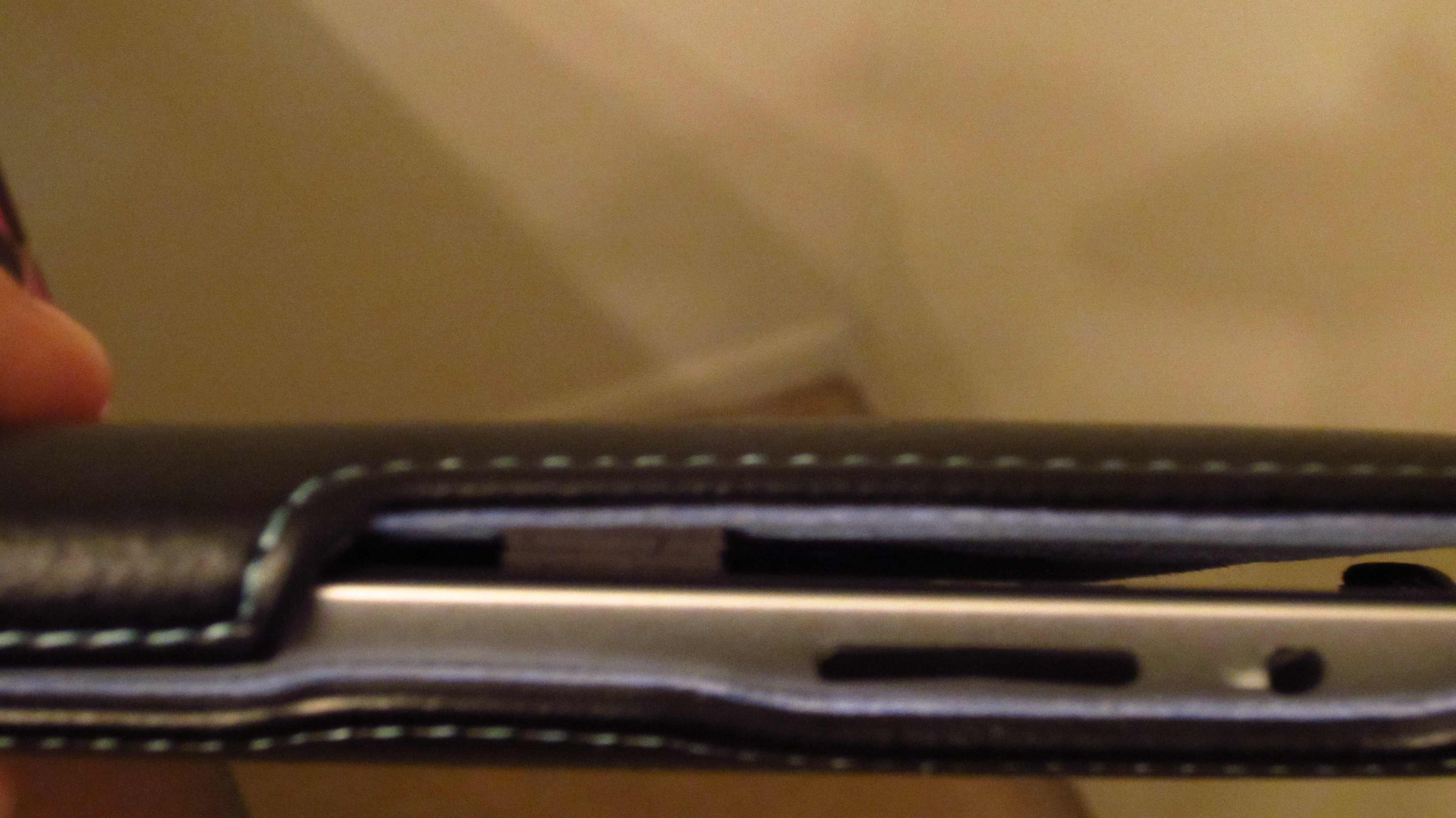

Also, I just cut the square to 1/4 the size of my original pics earlier in the thread and it still works! Looks like you can go pretty damn small to get the same smart cover effect. I've attached a new pic here.

Oh, and BTW, the magnet I'm using is SOFT. I can bend it to break the amount I need or cut it with scissors. Between that and a screen protector, I'd be really surprised that the glass would break (unless you sit on the iPad!!).
That's a very interesting method to trigger the screen on/off function, without the smart cover. My only concern would that there would now be a slight elevation between the cover and screen. Then again, the magnet is probably rather small.

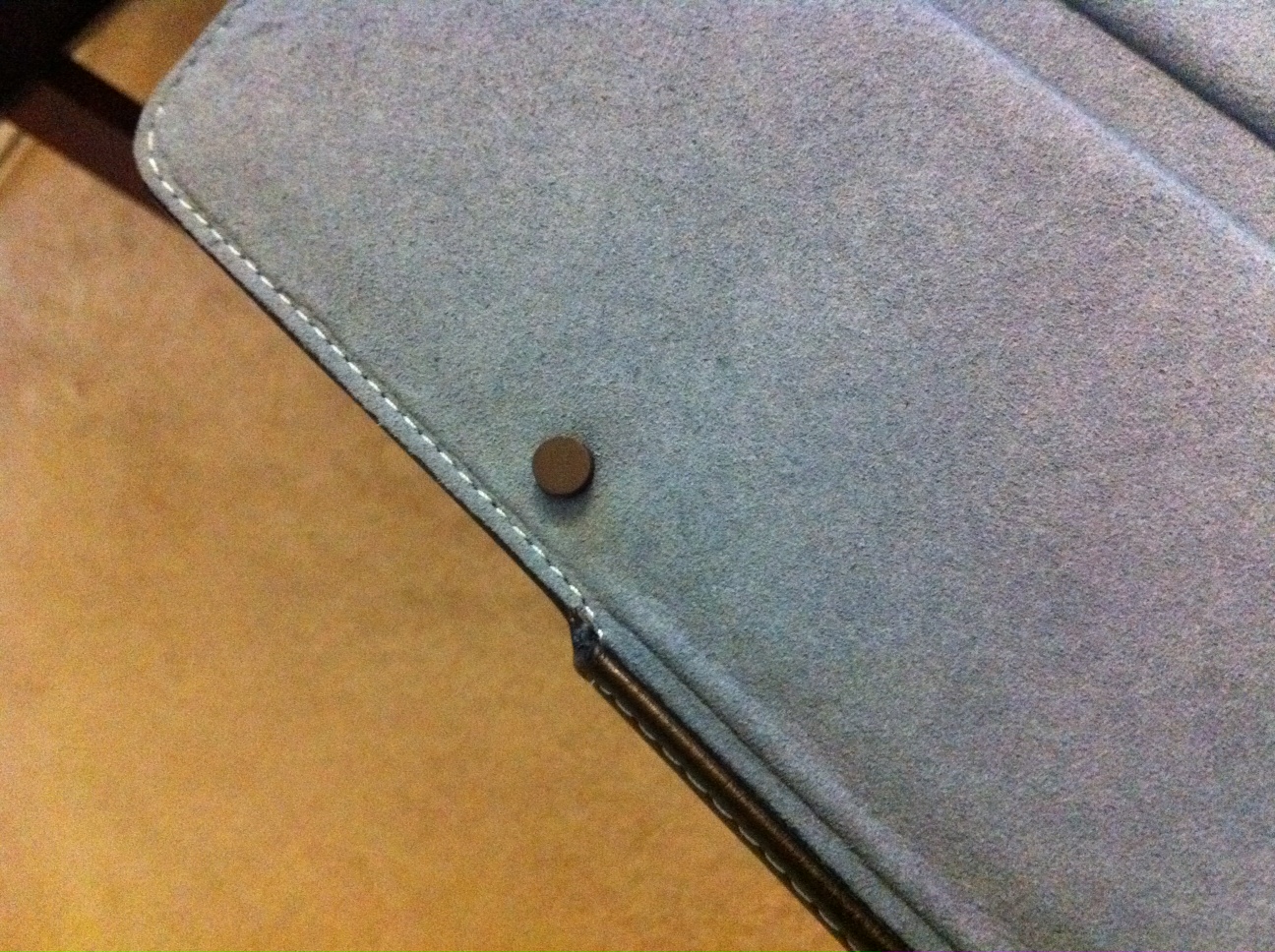

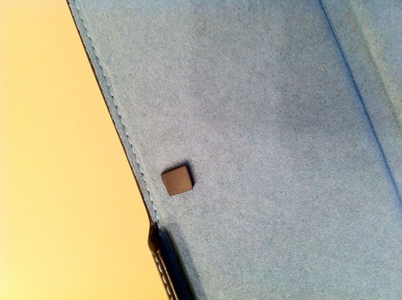

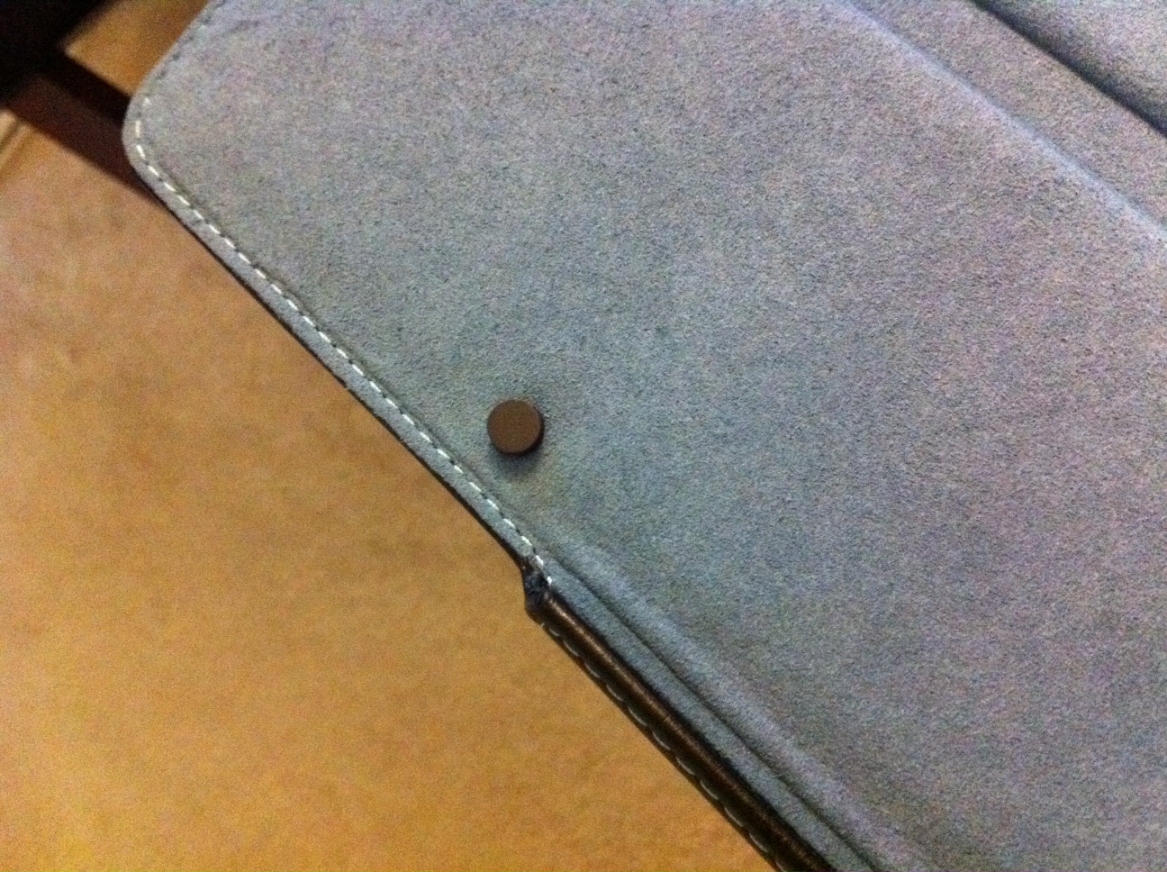

Revised yet again!
So, I found a hole puncher in my toolbox, punched out two circles, stacked them and wallah! Super tiny, works perfectly.
