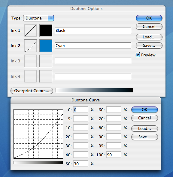

Best: PHOTOSHOP DUOTONE (advantage: absolute control over 2nd color midtone)
  1. Convert image mode to Duotone.
  2. Select "Duotone" from the menu in the subsequent dialog box.
  3. Click on the second square and select a Pantone color similar to cyan.
  4. Name the second color "cyan".
  5. Click on the curve and drag its center down. Refine curve for specific image.
  6. Save image as Photoshop EPS (with screening and transfer function options disabled).
Before closing the Duotone Options dialog, press the Overprint Colors dialog and make certain the black is 0c, 0m, 0y, 100k.
Screenshot provided...
I was beginning to wonder if I was the only one who saw duotone as the obvious/simplest solution. Channels....DCS...those are the hard way. Duotones are simple and flexible.
