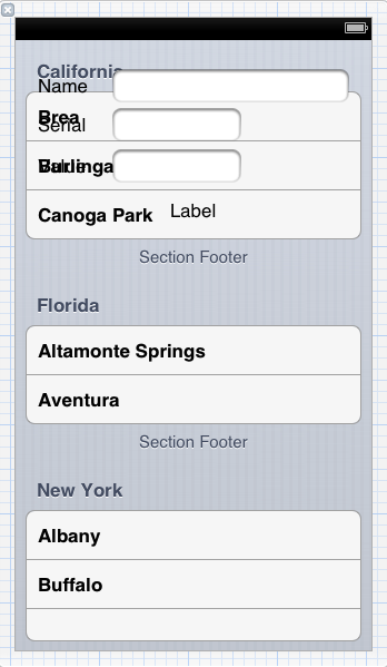

I have done this, and it works, but the table view that you drag out of the object library in Xcode is full of preset example table view cells. It makes viewing the real content of the view pretty awful (see screenshot).
Is there any way to blank the table view so that it is empty and therefore completely transparent so that I can work in interface builder without all the preset stuff spoiling the canvas?

Perhaps that's the answer - there are examples of doing it in code via that link as well, and given that it isn't meant to offer any functionality it would be pretty easy to do. I also see there is a "send to back" method as well so it will be easy to put the table view behind the text fields and labels.

So I suppose the upshot is that programmatically creating the table view is the best approach to achieve the grey background whilst not having the example cell clutter in interface builder.

In the spirit of answer completeness for anyone reading through this in the future and doesn't know, I added this code to the viewWillAppear method of the view controller, and it works a treat:
Code:
UITableView *backgroundTableView = [[UITableView alloc] initWithFrame:[[self view] bounds] style:UITableViewStyleGrouped];
[[self view] addSubview:backgroundTableView];
[[self view] sendSubviewToBack:backgroundTableView];
Edit: probably should be in viewDidLoad actually
You can use insertSubview:atIndex: to put the tablewview where you want in one call. Also, I set the resize mask so it resizes when the device rotates.
