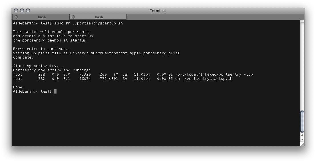

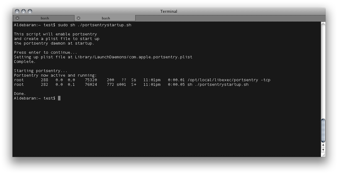

Ah Portsentry. Takes me back to them Linux days. So what happens when you run those commands in Terminal? Does ps aux | grep portsentry shows they're running? Also Portsentry is not standard on OS X. Did you compile it from source or did you install it through MacPorts or Homebrew or a precompiled binary for your system? Seems like you've been trying for some time to get this going as per this link : http://www.cemetech.net/forum/viewtopic.php?t=8474&postdays=0&postorder=asc&start=0. You ask on that link to start the following Terminal commands on startup :
Code:
sudo /opt/local/libexec/portsentry -tcp
sudo /opt/local/libexec/portsentry -udp
yet your first post here states this :
Code:
/opt/local/libexec/portsentry.sh -tcp
/opt/local/libexec/portsentry.sh -udp
Like chown33 said the result of the chown and chmod is that the script is only executable for the owner (root).

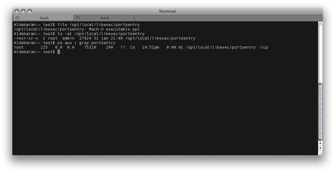

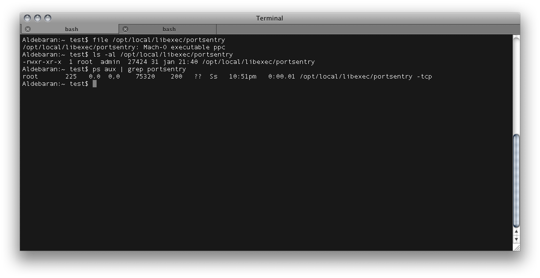

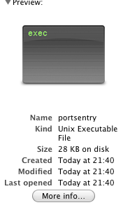

Edit : I installed Portsentry via Macports and lo and behold it was installed in the /opt/local/libexec/ directory. As you can see in the screenshot it's a Unix Executable File and doesn't end in .sh.
The contents of com.apple.portsentry.plist file :
Code:
<?xml version="1.0" encoding="UTF-8"?>
<!DOCTYPE plist PUBLIC "-//Apple//DTD PLIST 1.0 //EN" "http://www.apple.com/DTDs/PropertyList-1.0.dtd">
<plist version="1.0">
<dict>
    <key>Label</key>
    <string>com.apple.portsentry</string>
    <key>ProgramArguments</key>
    <array>
        <string>/opt/local/libexec/portsentry</string>
        <string>-tcp</string>
    </array>
    <key>RunAtLoad</key>
    <true/>
</dict>
</plist>

Edit: So, your example works fine and PortSentry starts up in TCP mode. Now, I would also like it started in UDP mode too. On the command line, you have to actually run the command twice to start it in both modes. Must I create another plist file?
