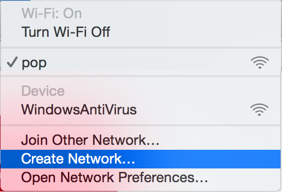

You can ALSO setup one of the mac minis or any computer actually as a wireless server. On a mac it is as simple as clicking the WiFi icon > Create Network. Give it a funny name, something like WindowsAntiVirus and have the rest of the computer connect to this computer via their WiFi. The WindowsAntiVirus computer should have a web server (MAMP) running for them to pop into by default. A simple WordPress site with links and daily assignments is what we have in our test lab. This isolates the lab from the 'real' internet and allows the lab to see only what you've previously downloaded and made accessible. It also focuses them on the daily tasks. Easy to do and up to 255 clients can connect simultaneously.
iPads, windows computers, androids, Macs, whatever can 'log in'.
While that is a good suggestion and may suit your needs perfectly fine, the sheer amount of bandwidth required for the audio and video resources to move across the network is insane and would likely be too much for the internal Wi-Fi card. I am suggesting that they wire everything into a 48 port Ethernet switch which would provide a gigabit backbone to the server.
