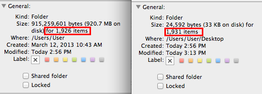

*1st test: Phantom folder created!
*2nd test, small folder with subfolders, works! (84mb ->90items)
*3rd test, small folder with Phantom folder already there. Files get added to existing folder. New files in a sub folder get added to the appropriate subfolder, so changes to the real folder could be synched to the subfolder.
*4th test, large folder with subfolders (6.48gb, 687 items) works...though 72 more items seem to show up...maybe resource forks or .DS_Store 's?
didn't notice that on previous test with small folder, so will retest that.
*5th test, small folder for file # inaccuracy...90 items to 90 items.
*6th test, medium sized folder-more items. (915MB - 1926 items) - 5 more items in phantom folder
Compare two folders using Chronosync's analyzer...no file discrepancy found...on a test sync, no files not on original are found on phantom (intentional file discrepancy added to confirm test works).
Prelim conclusion: File discrepancy is based on how Finder's Get Info relays # of items and invisible files.
Yes, they do. I considered it a feature (a free but useful side-effect).
If you want a clean slate to start with, then trash any existing Phantom folder on your Desktop first. Or just rename it.
The extra items almost certainly aren't due to resource forks. A resource-fork is a named xattr of an existing file. It won't be a separate file, EXCEPT on non-HFS file-systems. Then it's a "companion file" whose name starts with "._", and those WILL be replicated by the code I gave.
I did not exclude files that start with "." or "._", because that seemed like a little too much liberty in deciding what to replicate. That exclusion (i.e. of ".*" or "._*" files) can be added, if it's important to you. It's not a big or difficult addition.
If Finder isn't counting ".DS_Store" files, then it should be consistent. That is, any ".DS_Store" files in the zero-length replica would be counted or not, the same as what's in the original.
That could be. I don't know how Finder determines its item count. Experiments could be done, but since your check shows no actual discrepancy, it doesn't seem worthwhile at this point.
