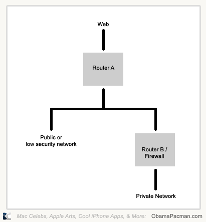

Yes, if they break into the access point with WEP, then it's just as if they are on your other wireless network.
See graphic for a suggested set up in this situation.
Me
Router A: G
Router B: N 5ghz only WPA2
You
Router A: WEP
Router B: WPA2
Of course if you REALLY care about security you would have only bought a device with WPA2 security. So, just set routers to strong passwords, and you'll be set. With Router A you can set a bandwidth limit for Router A wifi if you are paranoid.
