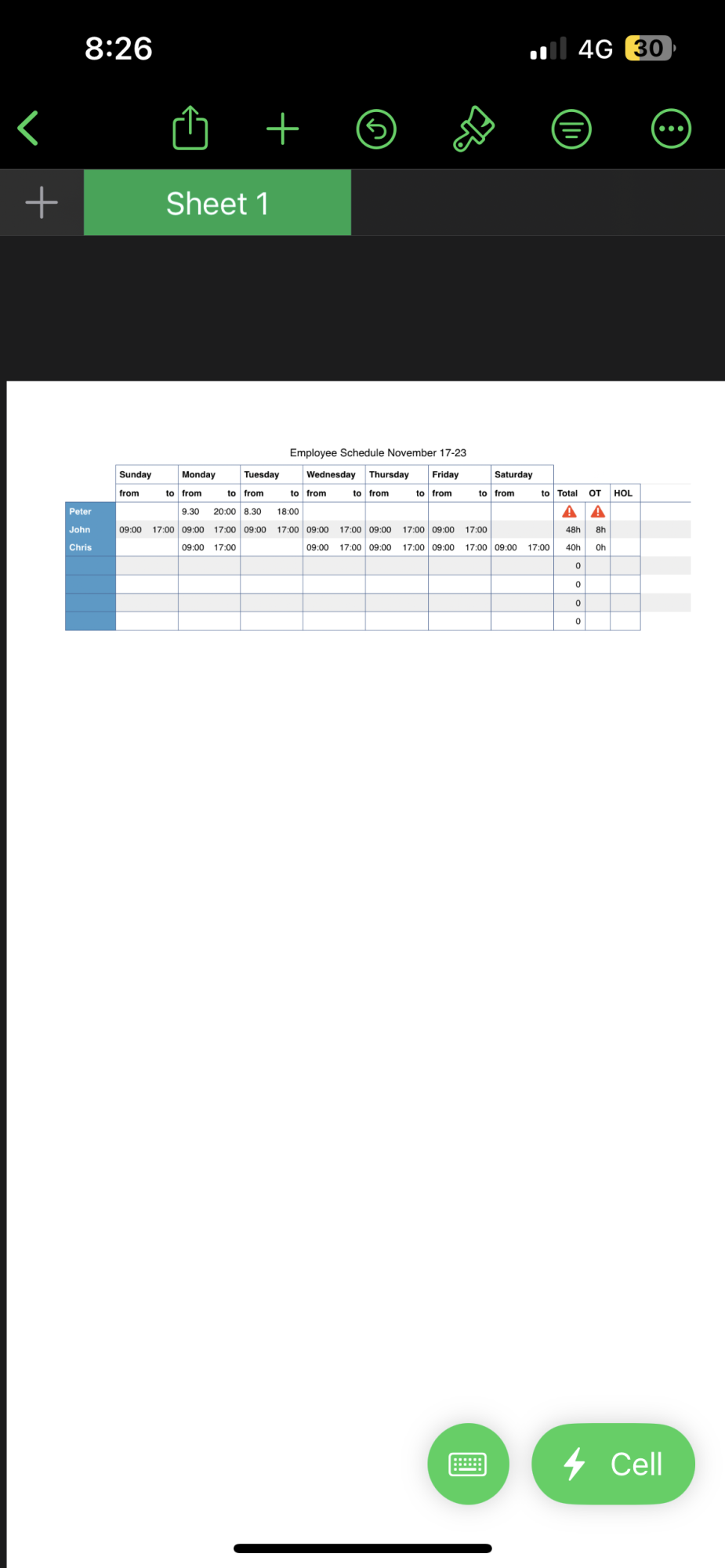

Hello, sorry hoping you’ll reply back even though this was years ago. I went to use your spreadsheet you’ve shared but I don’t understand it. Please could you help sorry
