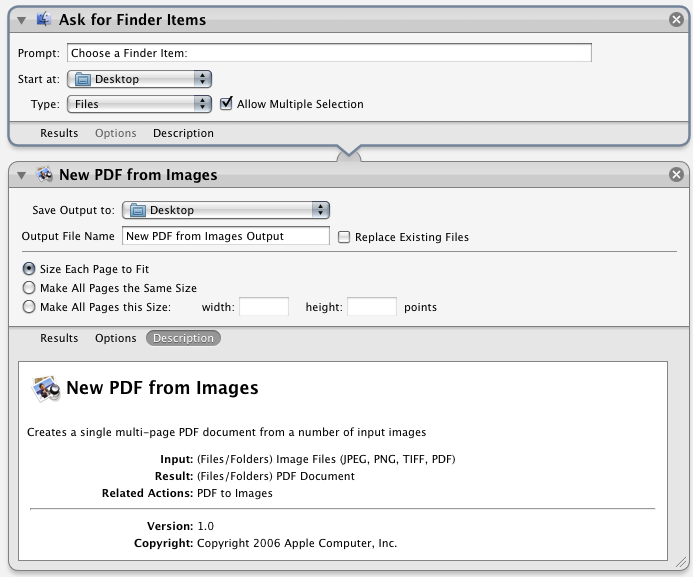

Anybody know of software to create a PDF from a bunch of images that I scanned in from my Epson printer? I am using leopard on a PMG5.
I suggest you look into Automator. I has a New PDF from Images action you can use.
Tip : You can also use Get Selected Finder items or Get Specified Finder items as your first action. From Snow Leopard and on you can even create a Service. You can even make an application where you can drop files on to process. Start using Automator today, Otto is there to serve you.

Very cool Kryten2! Thank you for the screenshot, I set up a Desktop folder action for this & will use this a lot.

Yes. The screenshot was made on a powerpc based Mac mini that runs Leopard.

Thanks I had never used automator before and wasn't sure how it works but it seems to do the job well.

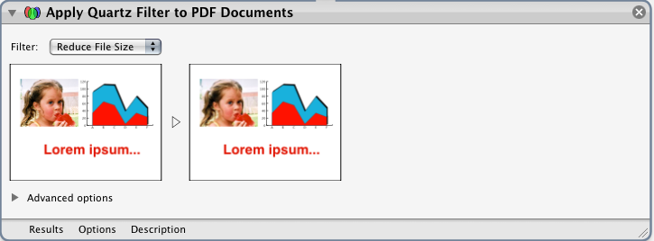

Does anyone know how to make the pdf file less than 10mb? I can't seem to figure it out. Currently seems to be around 91mb

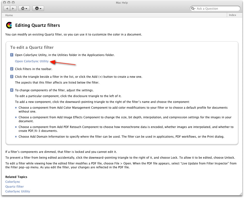

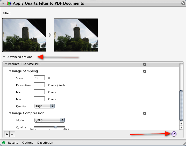

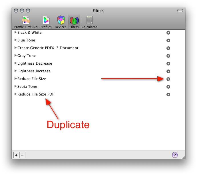

Add an Apply Quartz Filter to PDF Documents action after the New PDF from Images action and in the Filter: drop down choose Reduce File Size. That filter is kind of overkill, it reduces a file from 30MB to 500Kb. Filter is locked so you can't change anything. You can duplicate a filter in the ColorSync Utility. In the Apply Quartz Filter to PDF Documents action click advanced options then click the question mark. In the Editing Quartz filter Mac Help window click Open ColorSync Utility. In the ColorSync Utility app goto the Filters tab and click the downward triangle besides the Reduce File Size and choose Duplicate Filter. Give it a meaningful name and change some settings to experiment with low file size and good quality as result.
Tip : You can try this with your 91Mb file.
To edit a filter while viewing how the edited filter modifies a PDF file, choose File > Open. When the PDF file appears, select “Live Update from Filter Inspector” from the Filter pop-up menu. As you edit the filter, your changes are reflected in the PDF file.
Edit : Duplicating a filter can also be done from the Apply Quartz Filter to PDF Documents action but your duplicate is not selectable in the Filter: drop down menu unless you delete the action and drag it back in again. Well at least it wasn't for me. YMMV.
