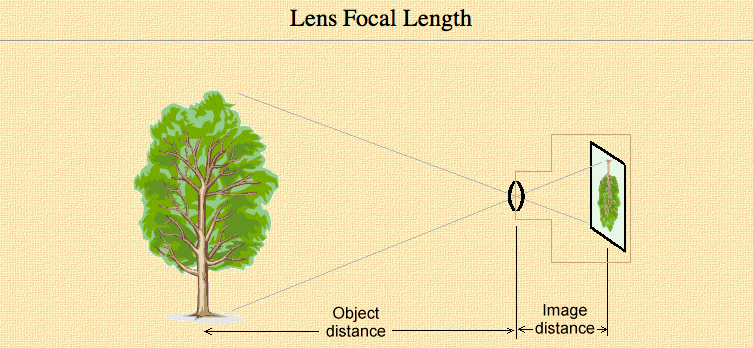

Focal length is not to be thought of as a magnification factor. I'll see if I can look it up and edit this post.
Here's my edit:
This link explains focal length without all the math involved:
http://www.paragon-press.com/lens/lenchart.htm
Here's a screenshot:
If you have a short lens like a 12mm, the lens is close to the sensor plane (12mm away) and the field of view is wide (wide angle). It the lens is long, the distance between the lens and sensor when the lens is focused at infinity might be 400mm and the field of view would be narrow (telephoto). It's not about magnification, it's about the angle of view of the lens.
Take a few moments to imagine what happens to those lines from the edges of the sensor as the oval that represents the lens moves closer or further from the sensor plane and you will get "focal length" and how it relates to "field of view".
Dale
