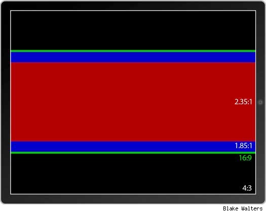

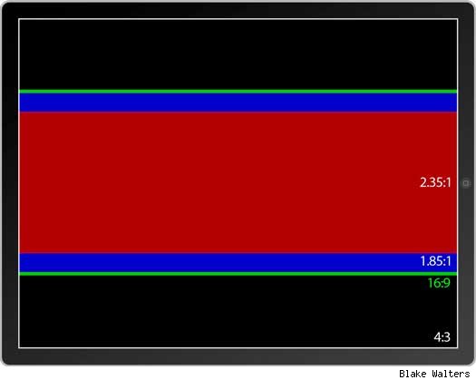

I know that but my video has an aspect ratio of 2.35:1 so when I zoom in on the videos app i will be losing a substantial amount of video.
See pic below.
See pic below.

HobeSoundDarryl, I don't want the video to fill the whole screen, I just want the video in 16:9 aspect ratio. The black bars in 16:9 aspect ratio don't bother me but the black bars only bother me in 2.35:1 and 1.85:1 video where more than half of the screen is taken up by black bars.
