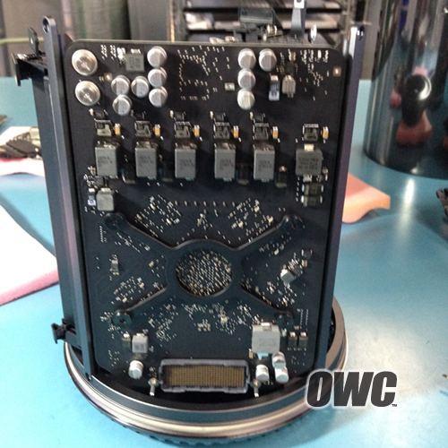

I'm betting on no-bridge Crossfire. I'm just not seeing enough connectors back to the main board to think that there is a physical bridge there.
There are about 320 pins on that connector from my count, IIRC.
I also doubt its bridge CF, too easy to do via DMA.
Seems like more than a few.. (photos from http://blog.macsales.com/22108-new-mac-pro-2013-teardown )
rectangles facing up hanging over the edge of the bottom above.
But yeah. at least x16 PCI-e worth. the DisplayPort output lanes , and probably x4 PCI-w worth for SSD , and a couple for more power management and housekeeping are going to add up to more than a few.
It looks there is more coming off the GPU cards than there is coming off the CPU card's edge connector. It is more like a socket design where can pack more in that can just with edge pins.
