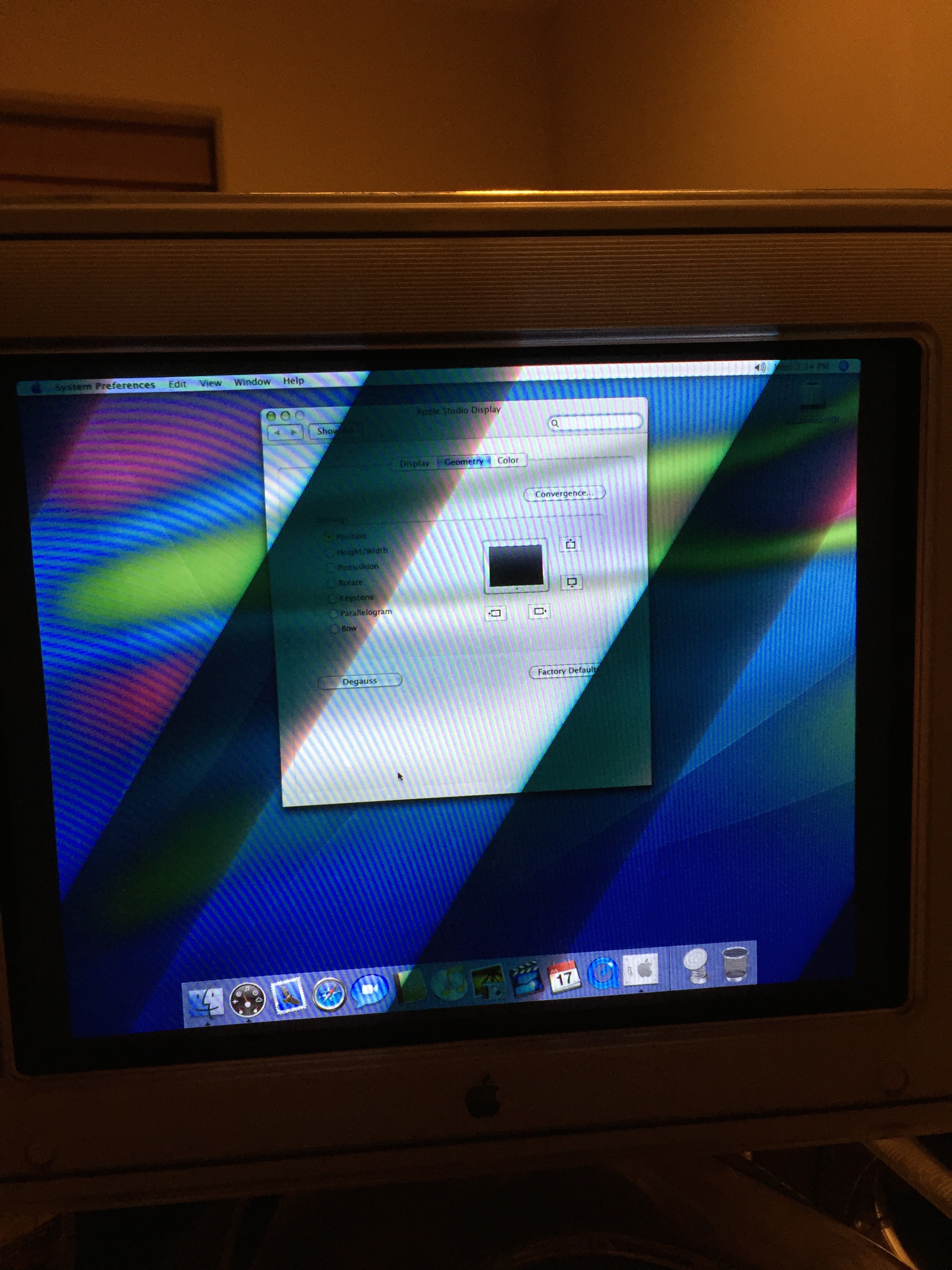

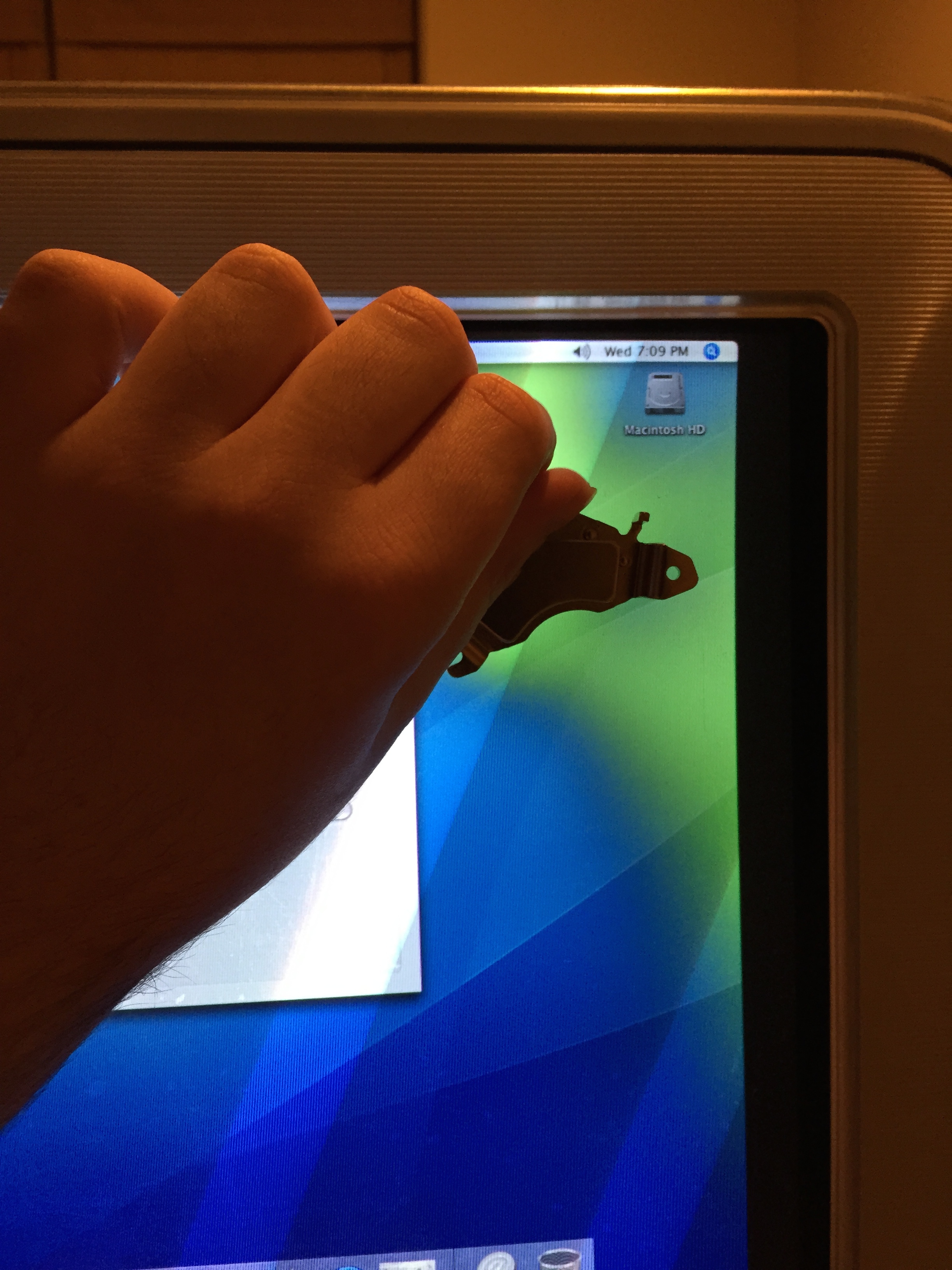

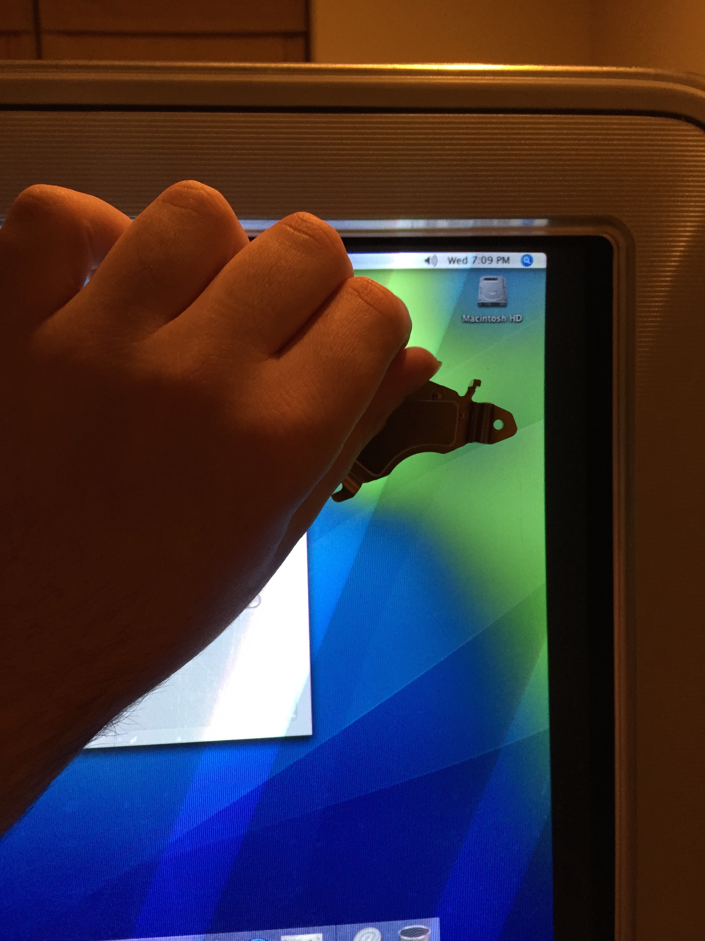

I decided to sacrifice an old 4gb Maxtor HDD to the cause, as I didn't have any other hard drive magnets handy.

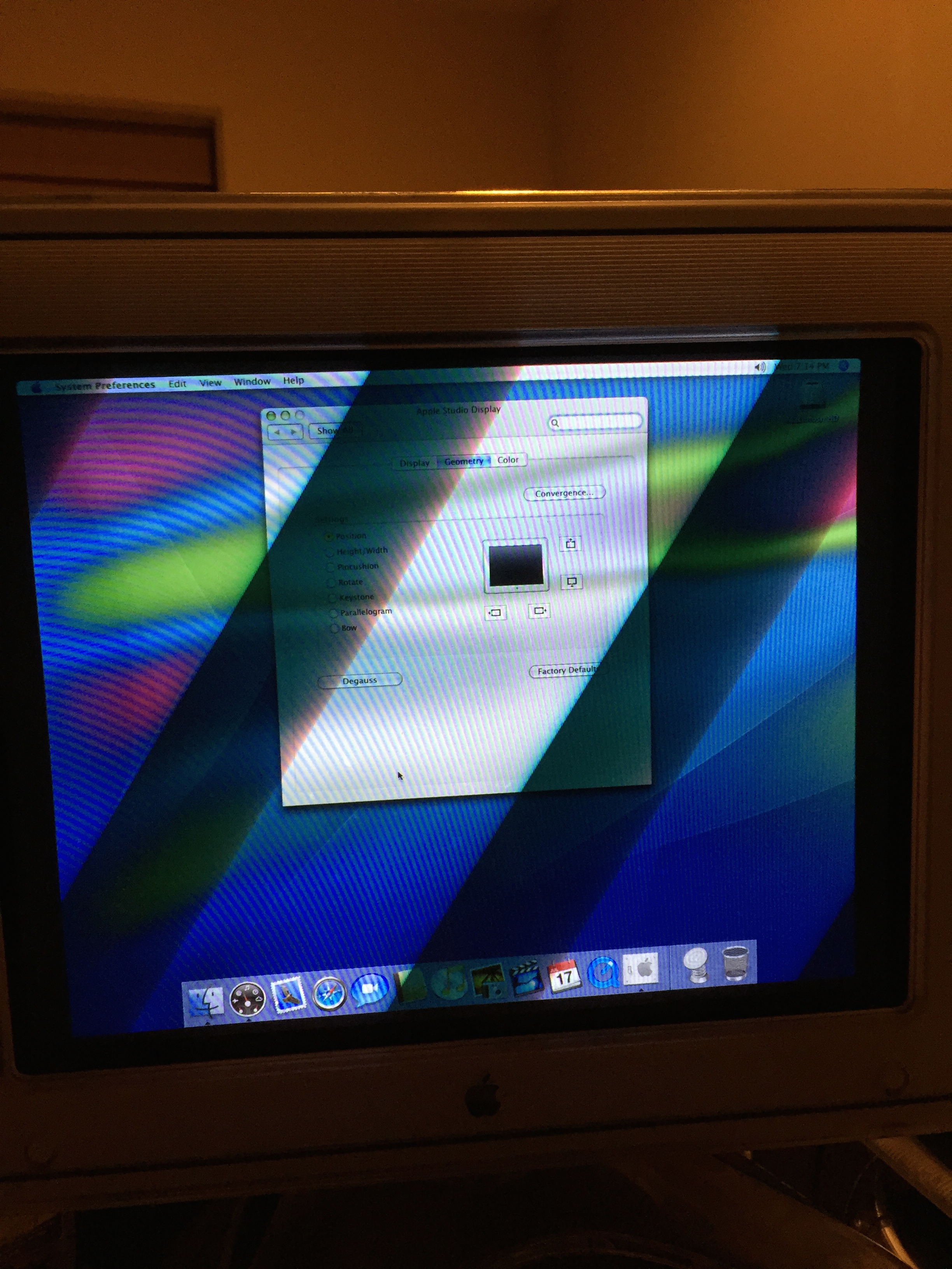

Interestingly enough, I was actually able to get the colors correct in the upper right hand corner of the screen at the expense of other parts of the screen. Degaussing returns the screen to the "normal" distortion that I showed earlier.
I didn't take the cover off, but thanks to the acrylic cover I spent some time looking at the tube. This stuff is slowly coming back to me, but all gun alignments are still at their factory glued and/or painted position.
I still wouldn't rule out a yoke misalignment, but don't know how to check other than getting in and poking at it-something that I'm NOT going to do until the claim is closed.
There's also a chance that I could fix it by attaching magnets to the side of the tube, but again not yet. This was actually done at the factory fairly often, and I suppose there's always a chance that one of the original adjustment magnets could have fallen off in shipping(although I don't see it floating around anywhere).
The beam convergence can be adjusted through software-I played around with that some, but it didn't make a difference.

The mask could also be bent slightly. Does the housing show evidence of the CRT being dropped? Unless there's something special about it, you could probably get a LCD for the price of shipping it.
There's no obvious damage.
There is something special about this particular CRT, and if this one ends up going back I'm going to look for another one.
