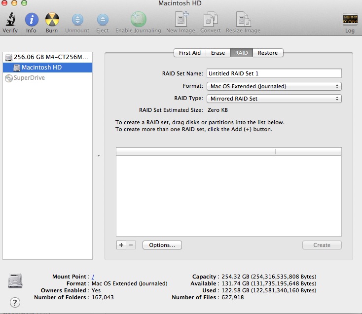

Just installed 256GB, cloned the data from stock drive via CCC and updated it's firmware I see trim is disabled how can I enable it for better performance? OS lion 10.7.3
Thanks
Got it thanks will I lose my info when I enable trim? I was looking at the drive RAID settings is this the correct configuration i have?

To OP: Use trim Enabler.
There is a known permissions issue with Lion that doesn't allow writing to root and it sometimes need to be granted permissions to work.
