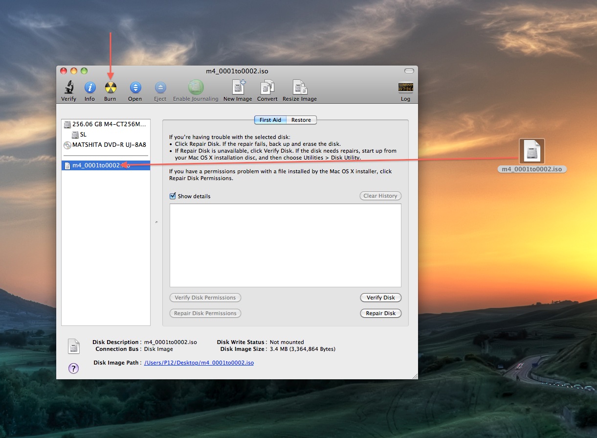

I'm trying to upgrade the firmware on my MBP but I'm running into issues - what am I missing here?
I downloaded the firmware from http://www.crucial.com/support/firmware.aspx and I've burned the .iso on the CD, but it's not recognizing it as a bootable CD. Do I need to name the disc a certain name? What am I doing wrong?

This is a known issue that Crucial are working on. The update seems to work fine for others though which is odd. I would try an SMC/PRAM reset and then try to flash the drive again.
You're not burning the iso as a file onto disc, are you? You need open Disk Utility and then go to the Images menu and select burn. It will ask you for the image to use, so select the iso from wherever you unpacked it and then shove a disc in the drive. Job done (pretty much).
Wow. n00b mistake. I've tried burning the .iso file - which I know is wrong. I also tried burning the mounted CD, which didn't work. I'll try this way and see. 😱
Edit: It's the same as burning the mounted disk. OSX is still not seeing the CD as a bootable drive.

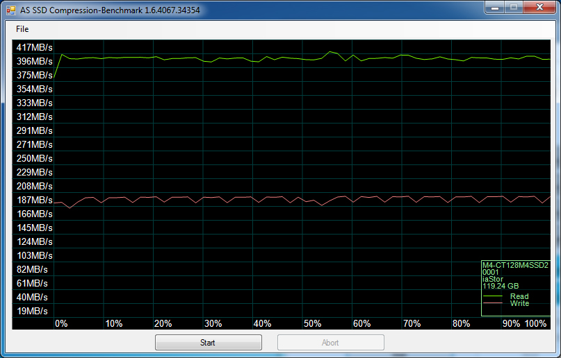

What many people don't know is that Sandforce drives (like Vertex 3 and OWC) only reach quoted speeds in new state with 0 fill data. Crucial M4 reaches quoted speeds with all data, in new or used state.
Here's what happens to the speeds of a Vertex 3 after serious usage.
Now look at the Crucial M4 after the same usage.
Just download the file. Don't mount it and burn as follows. Then hold down C when rebooting.
Are you naming the CD anything in particular or leaving it Untitled? I've burned a few disks that way too and the MBP won't boot it from the CD drive that way either.
