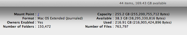

So I bought a Crucial M4 256 GB drive almost exactly a year ago. (Two weeks left.) The problem is, the amount of space used and free is highly variable, with no interaction from me. I'm not talking a gig here or there. I keep my drive relatively empty, typically with 100 gigs or so free. But just yesterday, it plumpeted down to 50~ gigs free and currently, I have 168 gigs free. Is this a sign of how SSDs fail? And if so, how should I go about resolving this? Contact Amazon or Crucial and ask for a replacement?

You may want to download daisydisk and analyze your space used in admin mode. These might be all kinds of temporary files. Maybe swap running wild or the swap used by a VM.
If it is the SSD the actual disk size should be shrinking, as in the same space used but less free.
So I emailed Crucial and this is what they said. (I didn't do anything else yet just in case the drive was failing; I didn't want to exacerbate the problem.) I'm going to try it just in case and see what happens. Hopefully this can help other people out if they encounter the same problem. I do have Trim and "Put hard disks to sleep when possible" selected already though.
"Thank you for contacting us. The behavior you are describing is consistent with TRIM commands not executing on the drive (which may result from lots of writing and rewriting, especially OS installs, not done on the OS level). You may have TRIM enabled, however it is likely there is an interference preventing TRIM from reaching the drive. The accumulation of 'junk' data from file deletions, even reformats, basically clogs up the drive and reduces or sometimes even halts performance and can even dismount the drive. A secondary feature called Garbage Collection activates when the drive is powered, but has no data throughput, for an extended period, and does background cleanup on our SSDs which can make up for the lack of TRIM.

Didn't solve my problem. I can't update the firmware without a CD and I don't have a CD on me at the moment. Any other possible solutions? Still two conflicting values for available space. 🙁
