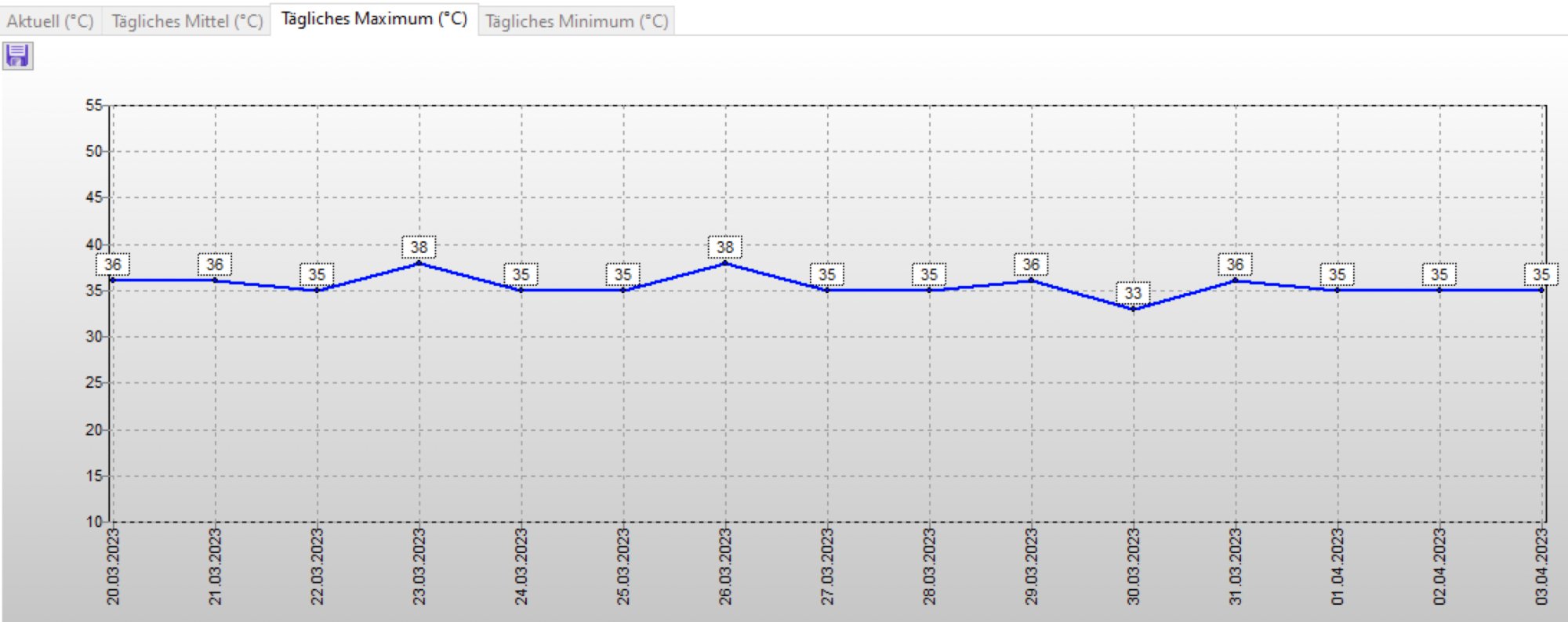

As you mentioned Windows, attached the maximum temperatures of my main Win10 server system SATA MX500. Mounted behind the motherboard. No active/passive cooling. Hosting/indexing several terabytes of HDDs via AFP/Plex. Writing 40 GB daily - reading multiple times that. Ambient ~72°F/22°C.

That's quiet interesting my original HDD (5400rpm drive) gets about 30-35°C, I read the mx500 gets 45-60°C.
