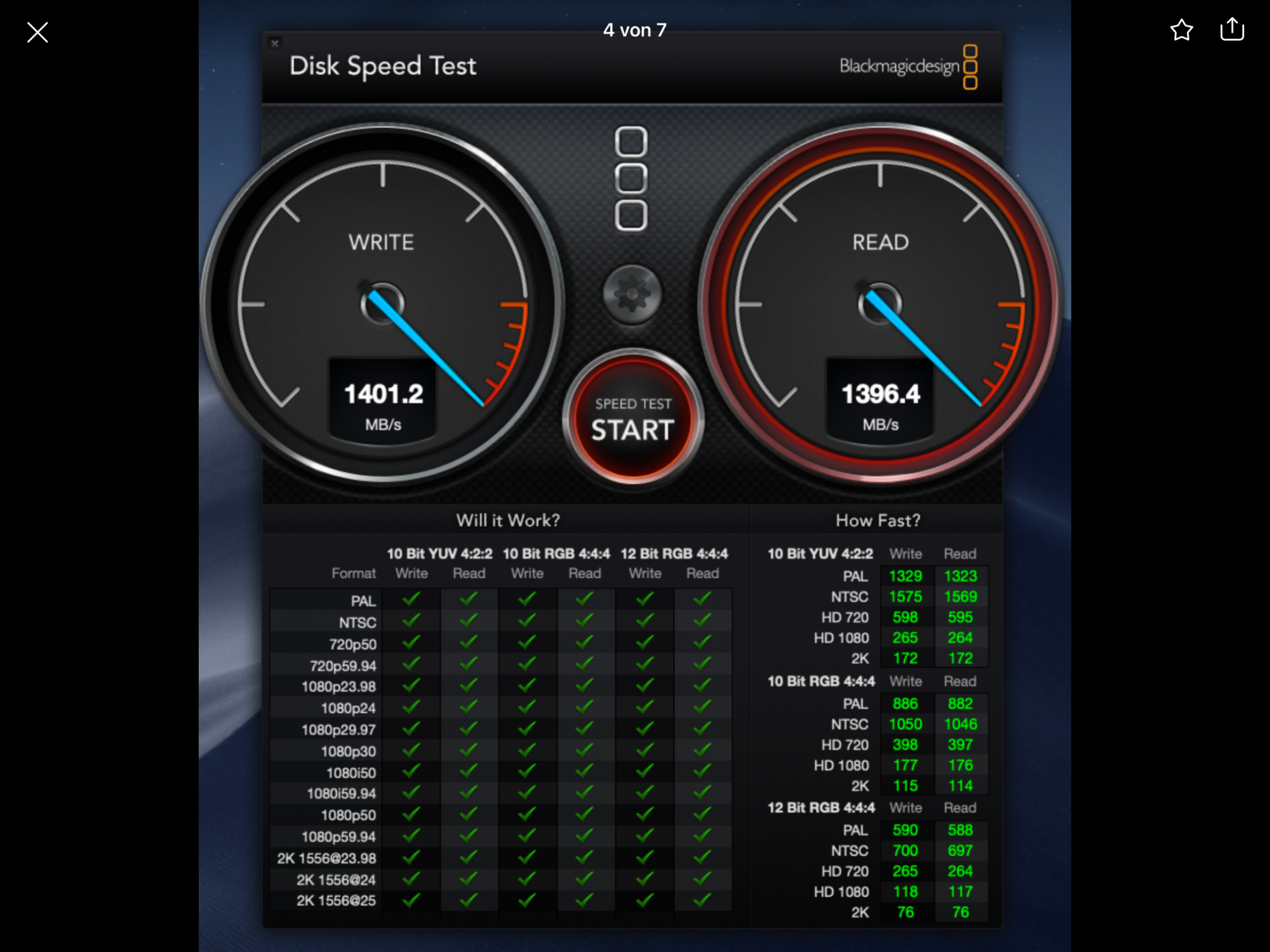

Hello,
IMO that sounds about right. Theoretical max * 80% real-life usage + factoring that particular NVMe's limitations/chipset, I would say that it sounds right.
Also remember that some of the bandwidth is being used for system services/running applications if you're using it as a boot disk.
I have almost the same setup and get a little more.
