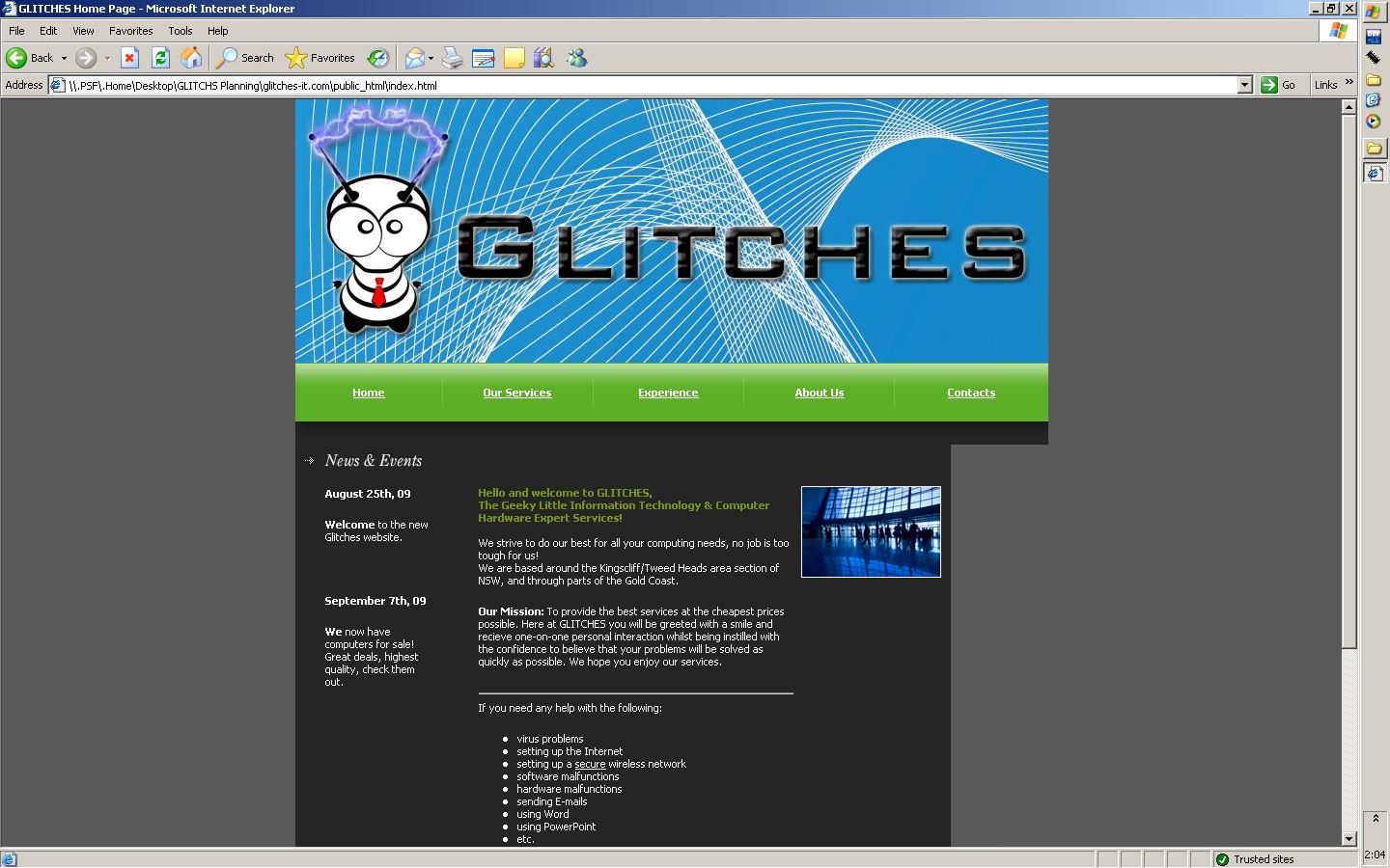

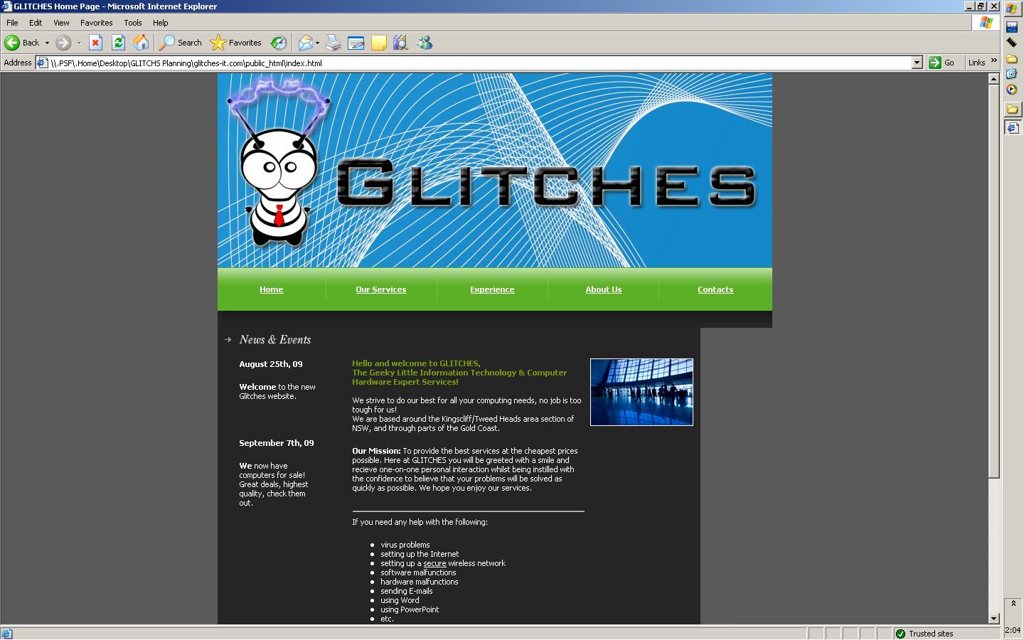

Hey all,
slight problem (see image). the very right <tr> tag likes to stuff up on IE.
Code:
<tr>
<td valign="top" width="68%">
<td align="right" valign="right" width="32%"></td>
</tr>
that is basically the code...
any ideas? (yes i know, recode needed) haha.
safari dev using IE doesnt see it as a problem, but my two VMs clearly do 🙁
also: if anybody wants to C&C the "flash" menu that i put on, its very simple and i dont think its too over the top. i have yet to put it on all the other pages.
Hey all,
Code:
<tr>
</tr>
Shouldn't the valign (vertical alignment) in the second cell be "top" rather than right? May also be worth removing the width statement from the second cell.
im not sure lol thats why i am asking here 😀 i will try it now. thanks heaps
Hey all,
Code:
<tr>
</tr>
If I'm seeing this right, you haven't closed the first <td> tag
Code:
<tr>
<td valign="top" width="68%">[B]</td>[/B]
<td align="right" valign="[B]top[/B]" width="32%"></td>
</tr>
Code:
<tr>
</tr>
you are seeing it right yes, but i quickly re-wrote the code - its not copy/pasted from the actual source. sorry - mybad. nice spotting tho! 10 points!
**will make effort to read thread first....**
Ok, just a quick scan using Firebug (its hometime here in Brissie)
Your "main tables" have a width of 780. On your "body table", you have two <td> elements.
The first, has a width of 150, the second 499, which doesn't add up to the 780. The class center doesn't seem to have any color attached with it. Now I think IE/Safari/Firefox have different interpretations of the "width" attribute for tables.
Try changing the second td width to 630. (will get back to you later if Im at home)
what an interesting webpage! thats great! i have been using safaris dev thing to look at it, this seems better 🙂
i didnt write the webpage, i purchased a template 🙁 thats why its written so bad. i will be doing a re-write in the coming months when i have uni off.
safari and FF see it fine, stupid IE. i will try fix it, thanks for your help.
p.s. NSW ftw 😎
