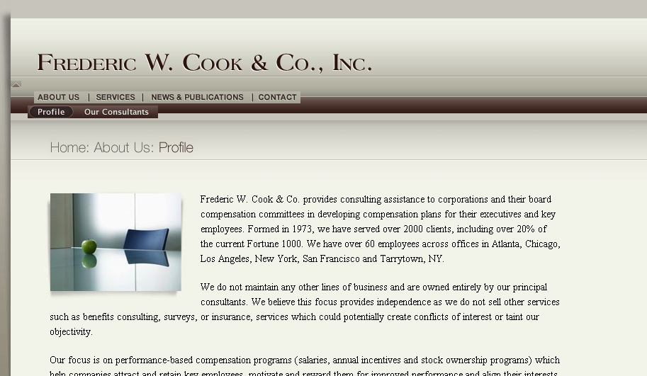

Hi, I am coding a website I designed and it's my first time laying everything out using CSS instead of tables. It's been a little slow going but I've gotten everything pretty much as I'd like.
The site is perfect in Safari and Firefox but when I tested my site in IE (ugh...) the main navigation and an arrow indicator are not aligned properly. What am I doing wrong? I'm not much of an expert so any help would be GREATLY appreciated!
Here is what I want to look like

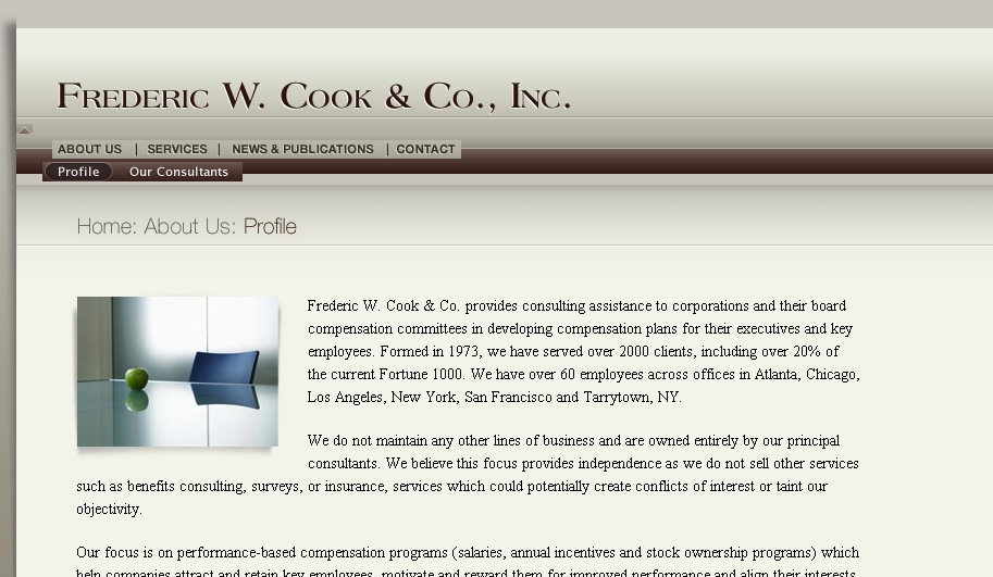

See attachment for an IE screenshot. Alternately you can see it using IE NetRenderer
Thanks in advance for any help, thanks!!
You've got some serious HTML syntax errors in some places and one is causing the problem for IE. So it's not your CSS. Thanks for providing the screen shot though. I always hate trying to make guesses as how it may look wrong in IE from a Mac.
Syntax issue 1:
HTML:
<bodyt" onload="MM_preloadImages( id="contac'images/
Good golly what is that? Delete the t" as well as the id="contac parts.
Syntax issue 2:
HTML:
<div id="about" "class="navArrow">
This the one causing problems for IE. Delete the " in front of class.
