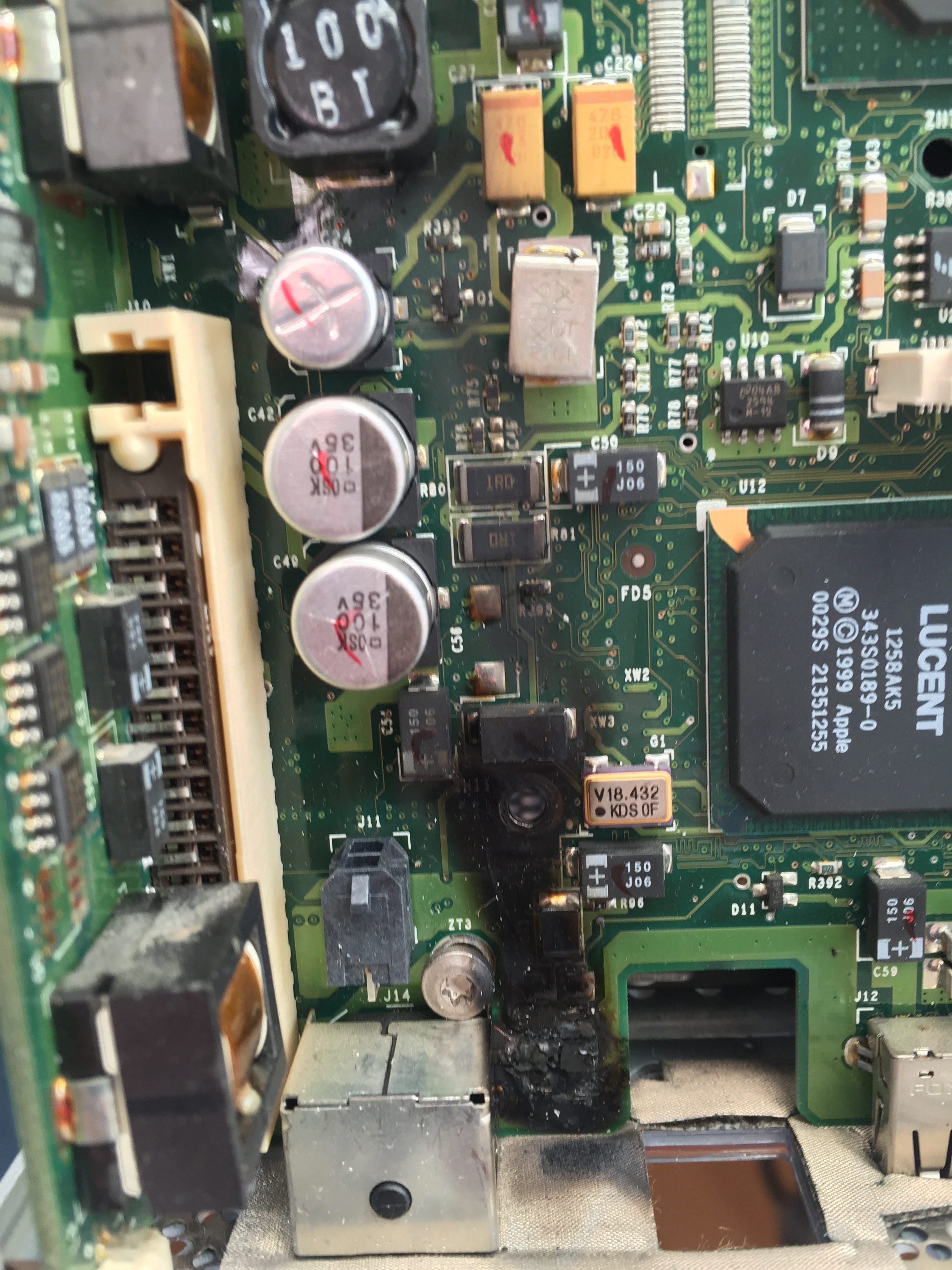

I can't believe I didn't notice this earlier, but had another look at it this morning and had a "There's your problem" moment.
I'm going to assess the damage on it, but I'm guessing this one is beyond repair and will need a new LB. I'm just hoping it didn't take out my Sonnet along with it.

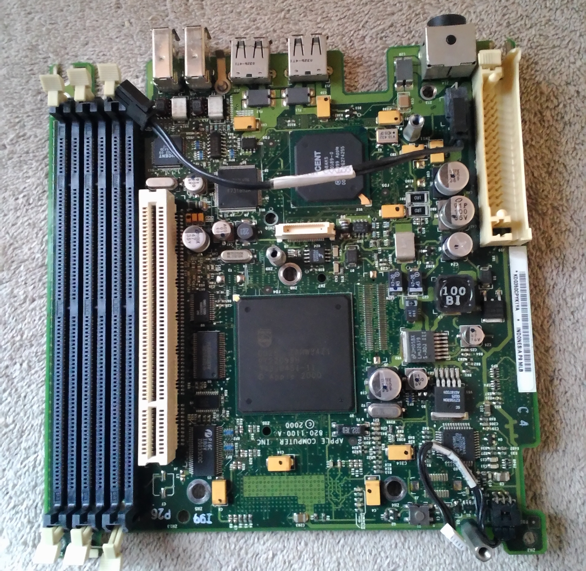

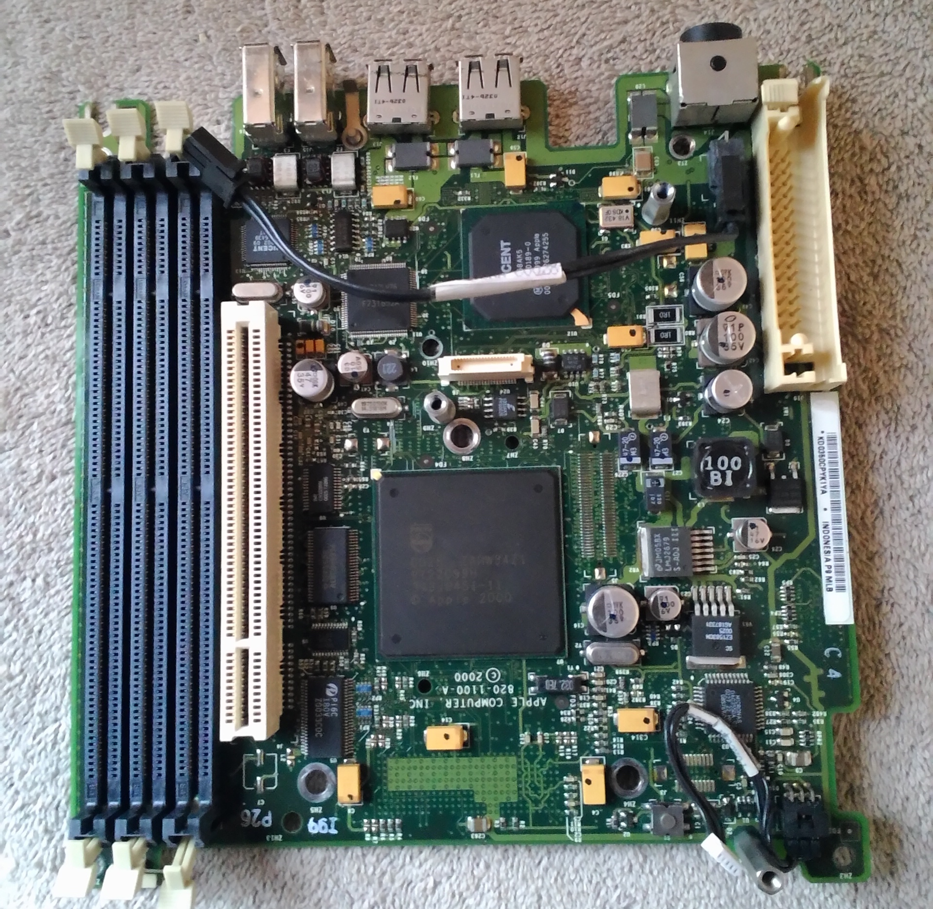

Guess I qualify as one of your "Cube butchers", but more to the point, if the item in the photo enclosed is of interest to you, it could be had for the cost of shipping.
PM me if interested.

That explains why the VRM was not getting 28v. I'd be interested in that fried board if you're just going to toss it...
Definitely-let me get them swapped and I'll be in touch.
No point in tossing it if someone else can get some use out of it.

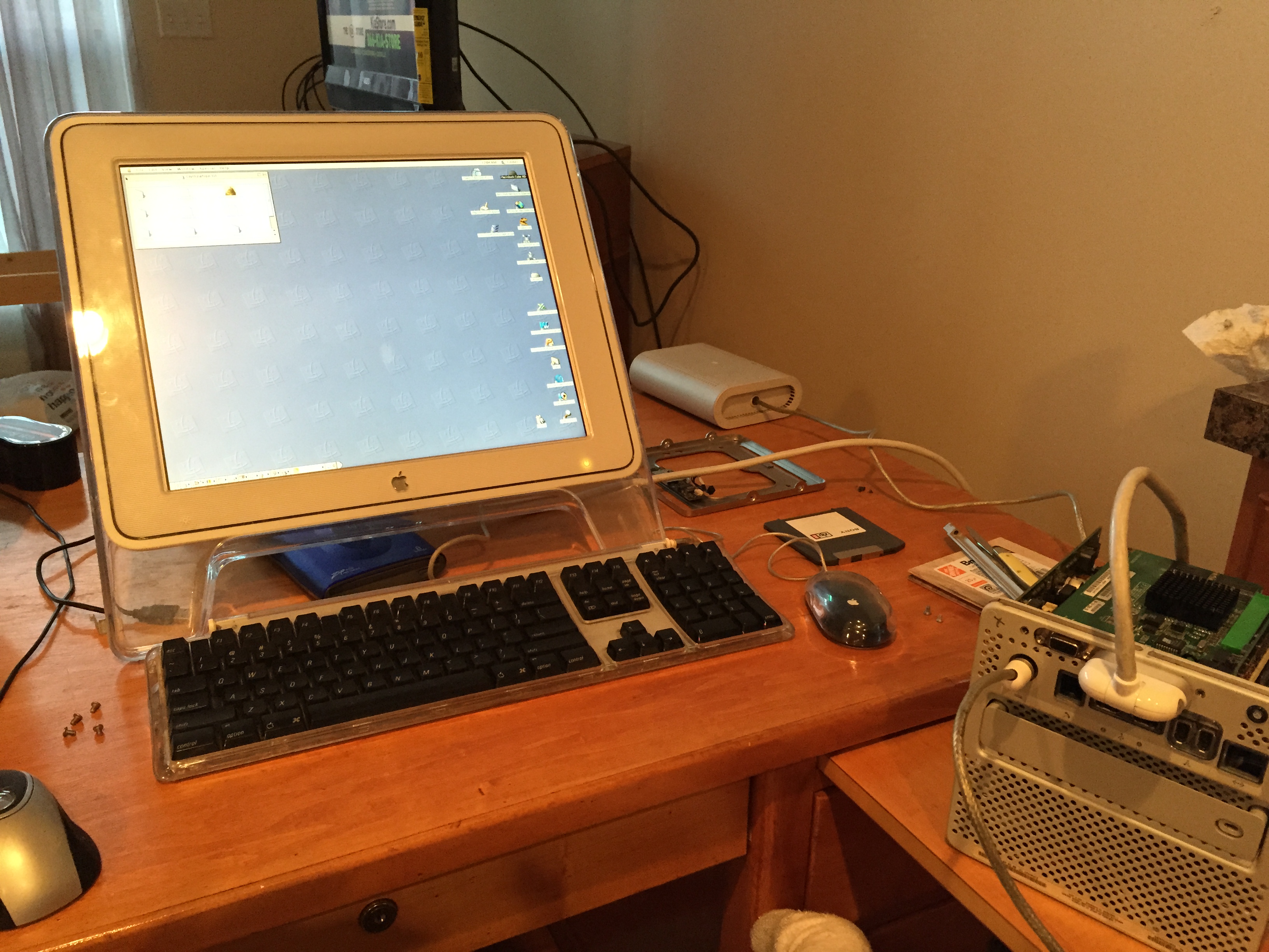

It's alive thanks to Jbarley!

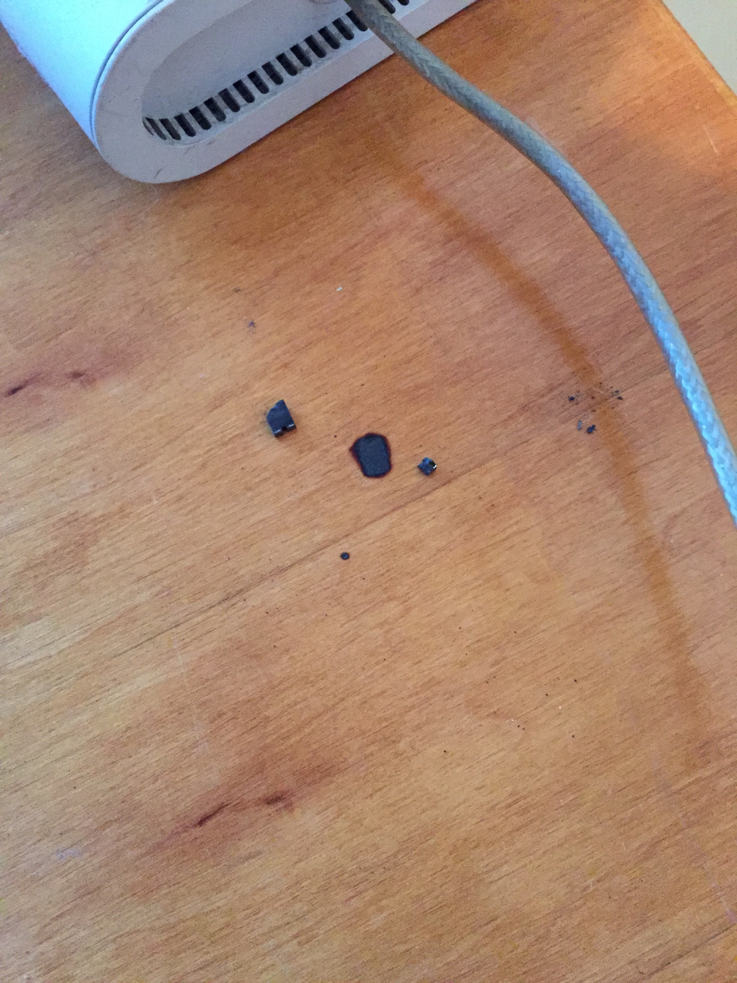

BTW, I'm not sure how it took me so long to find the problem. When whatever part blew, it REALLY blew. Aside from soot inside the top of the case, I found the below on my desk this evening
Apparently when the part popped, it either shot flames out the bottom or the part that fell out was hot enough to do it. I'm NOT happy about the burn mark in the top of my antique white oak desk, but no use crying over spilt milk.
