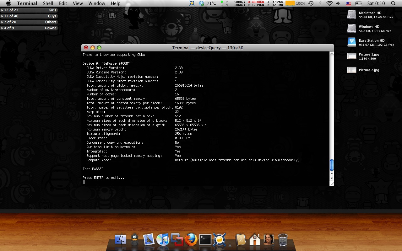

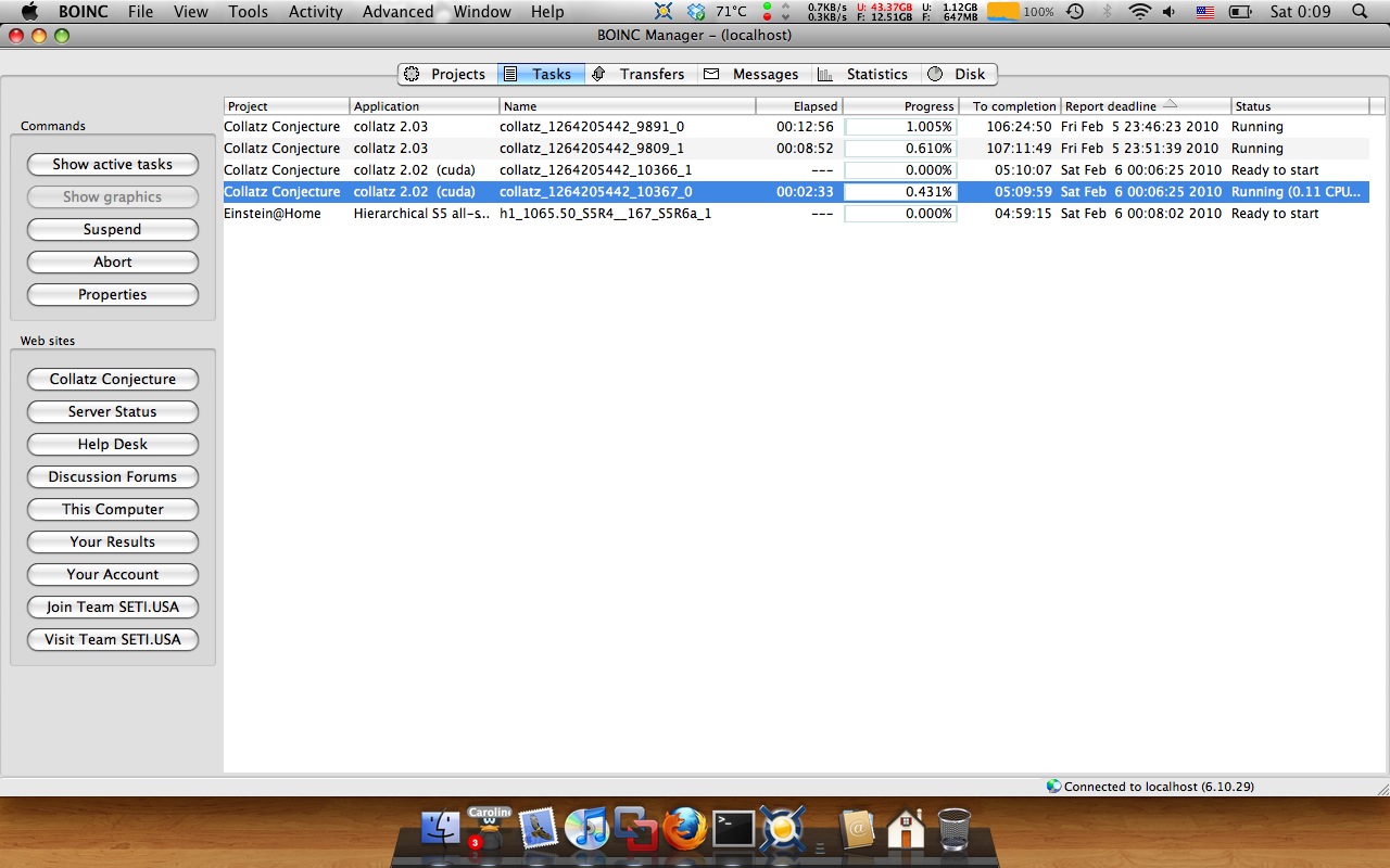

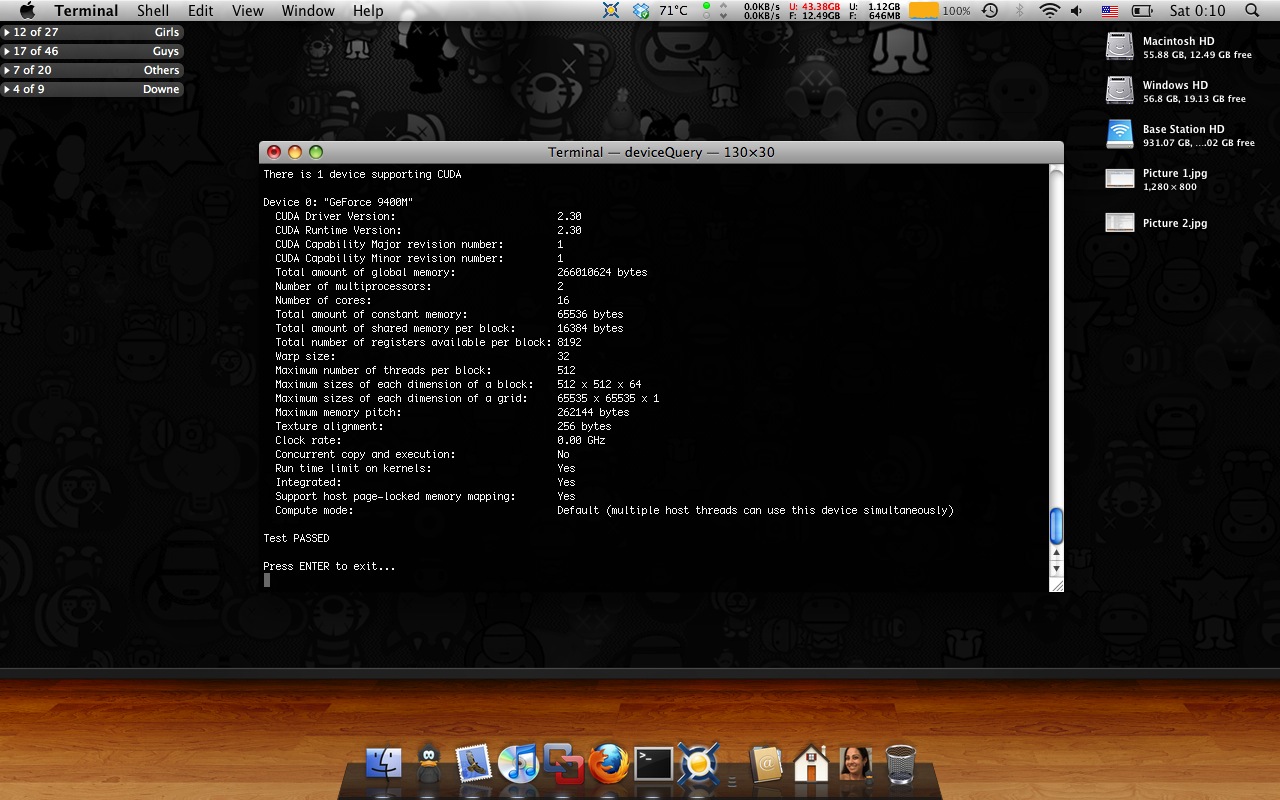

The latest version of BOINC in combination with the latest CUDA drivers seems to be working. Here's a few screenshots of Collatz Conjecture sending GPU work on the Mac platform.
Note, I'm still running Leopard.

Whats the command you used to check if the gpu supports cuda?
It's the same as the ones that support OpenCL. So from Apple.com....
GeForce 9400M, GeForce 9600M GT, GeForce 8600M GT, GeForce GT 120, GeForce GT 130, GeForce GTX 285, GeForce 8800 GT, GeForce 8800 GS, Quadro FX 4800, Quadro FX5600

Actually CUDA is slightly different from OpenCL but they're the same concept. The command I used is from the CUDA kit available at nvidia.com. Here's the exact link. You'll need to read the entire readme to do this, its not entirely just install and it'll run.
http://www.nvidia.com/object/cuda_get.html
You'll also need XCode to build the kit samples.
Pretty much almost all of the upper 8, 9 and GT1/GT2... etc. series support CUDA. Here's an more accurate list.
http://www.nvidia.com/object/cuda_learn_products.html

What I meant is the list of Mac CUDA cards was the same as the Nvidia OpenCL cards.
