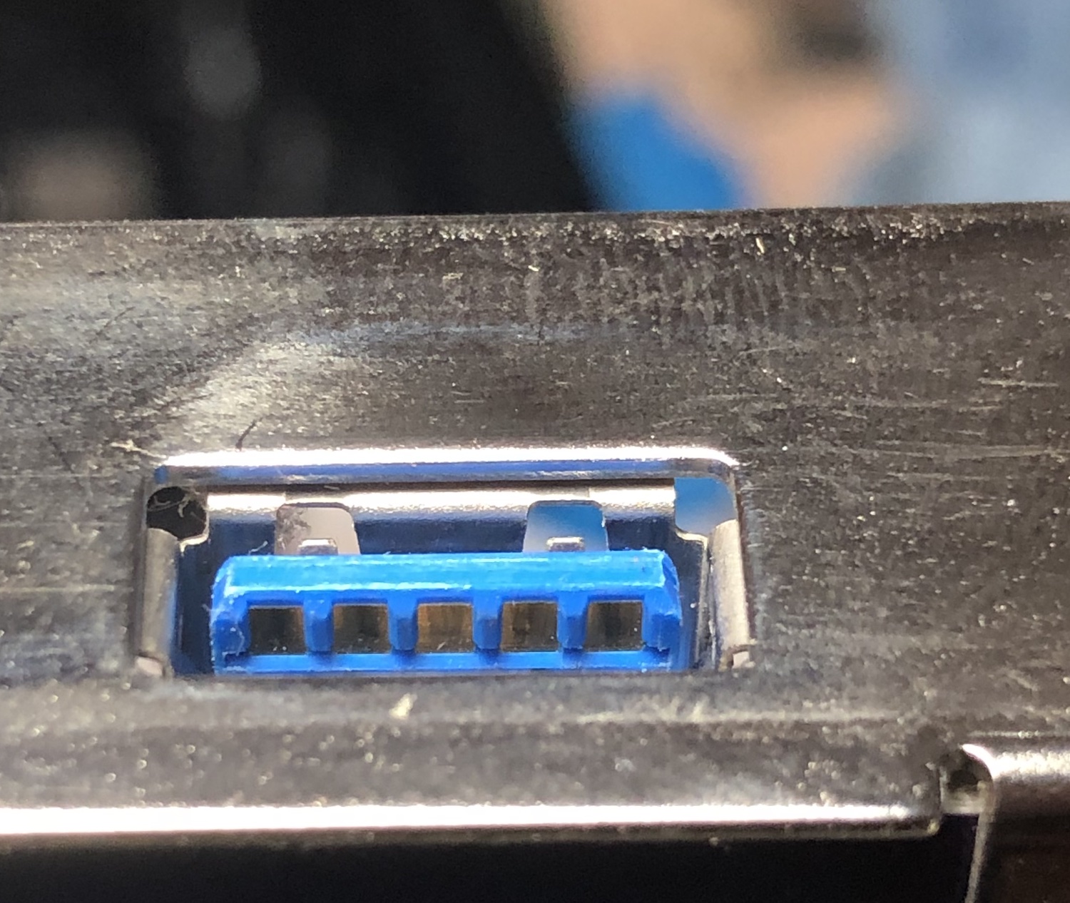

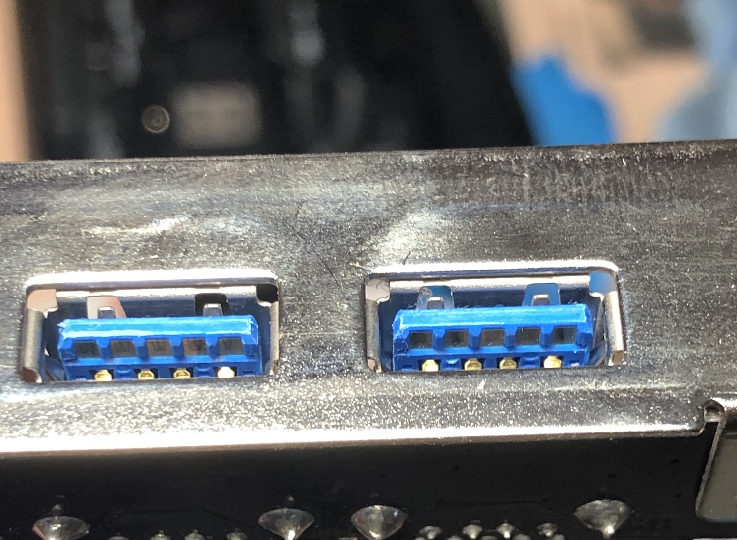

Here are few more, do they show it better? There are four flexible pins but five short brass things in the ceiling of the port.
You card only having four, do I see that correctly?
Or do the front 5 notches have contacts - can't really make it out here.
I had it in one of the slower top slots but I have now tried in one of the faster slots. I get 44 read and 44 write also there with the supplied cable and the Delock adapter.
I also found a few USB C to USB A cables at home and tried them with results at just above 40 read and write.
The USB A female of those cables all had four "pins" or whatever the flat brass things are called.
A possible difference to the Delock adapter is that (as the image earlier shows) it has five flexible pins but on the flat end it has four "pins".
That is what I couldn't quite make out before, the "five shorts brass things", confirming its USB 3, as its bleu colour indicates, but just as a confirmation 😉

I've now studied the USB 2 vs USB 3 page you linked to (thanks again for that). I the Delock adapter is rubbish because both it and the PCI card have the nine pins of USB 3.
No, it is actually good that both have the USB 3 nice pics. If one only had 4 pins it would be USB 2,

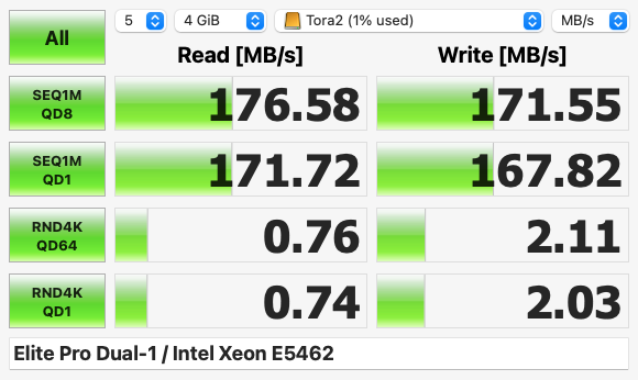

I have a Caldigit Fasta PCIe card (the 6GU3) in my cMP3,1 (in one of the two top (slower) PCI slots). The card has two USB 3.0 ports and two eSATA ports and I'm wondering about some readings I get in AmorphousDiskMark with various USB sticks and drives.
Here are readings from a Teamgroup MP44 256GB NVME in a Satechi enclosure connected with a USB C-USB-A adapter (USB 3.1). Don't they look rather low? It might be the adapter, which is a Delock I found on Amazon. But I would have expected better read speeds.
And these are readings from an Agfaphoto 16GB USB 3.0 stick. I get pretty much the same regardless of which of my USB 3.0 sticks I try.

The Teamgroup appears to be limited to USB 2.0 speeds. Check the USB tab of System Information.app to make sure your USB devices are connecting with USB 3.0 speed (5 Gbp/s) instead of USB 2.0 speeds (480 Mb/s).
Your Agfaphoto USB sticks are on the low side of USB 3.0 speeds but not unexpected for cheap flash drives. Compare the speed with a different Mac?

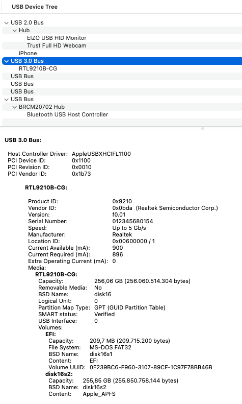

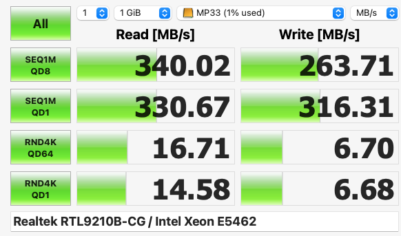

Thank you very much for replying Joe and for linking to that thread. I am using the Pro version (which is visible on the card because it's got the two internal SATA ports — something I think might come in handy if I ever were to get a MP 2019).
I will double-check Sys Info with respect to the speed at which the Teamgroup NVME connects once I have the new cable, but here's how it looks now, connected to one of the USB 3.0 ports with a Delock adapter:

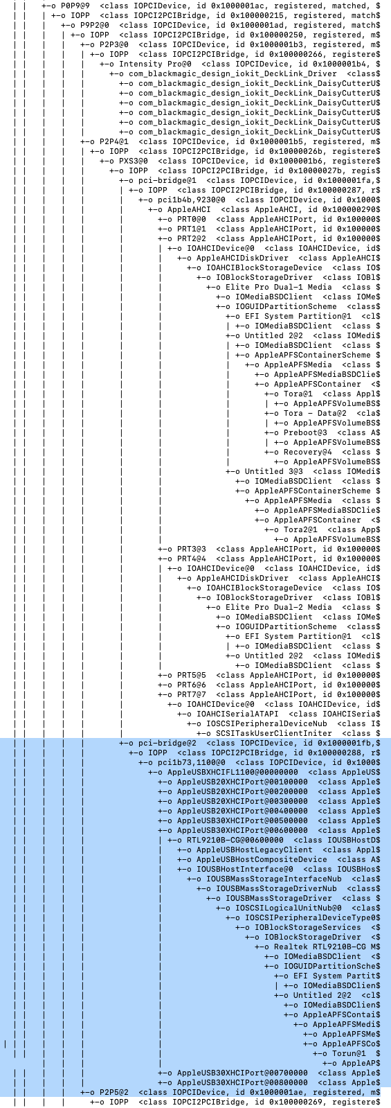

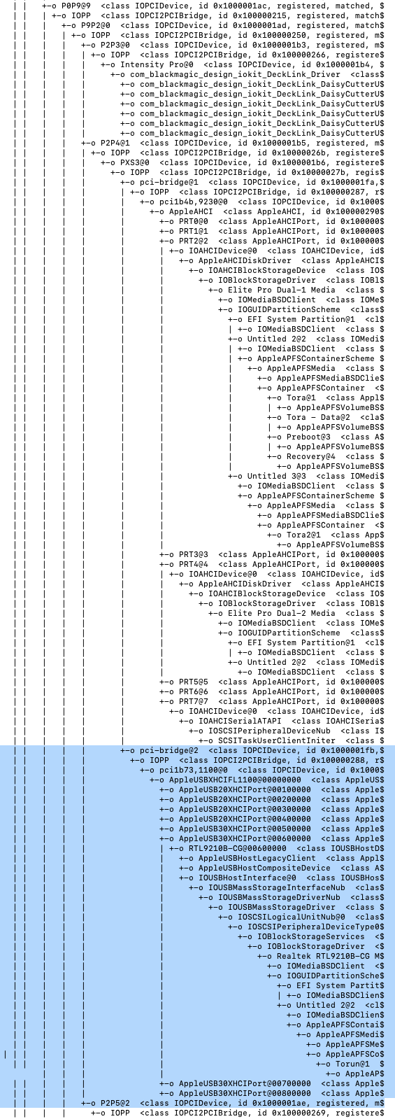

I took a look in ioreg and looked for pci1b73,1100 which is where Sys Info places the "USB eXtensible Host Controller" of the Caldigit Pro (see screenshots at the beginning of the thread). Here's the result with the Teamgroup/Satechi connected. I include the lines for the Blackmagic card I have in slot 4 but perhaps I should have included more above?
It mentions both USB 2.0 and USB 3.0 under pci-bridge@2 and it seems to say that the Satechi is connected via USB 3.0.

The USB drive does appear to be connected with USB 3.0 speed. Double check the USB info in System Information.app. You haven't shown a picture of that yet.

Thank you for continuing to help. Yes the NVME (Torun) and two HDDs (Tora and Yrsa) connected via eSATA in an enclosure are connected to the Caldigit.
I ran ioreg -lw0 and made a text file which I've zipped and attached. There are only two hits for "Torun" and all for the card's location "pci1b73" are clustered together and easy to see. I'm not sure what I'm seeing though as I'm unfamiliar with the various entries.
But here's the full USB info for the Caldigit USB 3 controller. I believe it says the link is 5Gb/s which I believe translates to 625 MB/s theoretical speed. I guess that's USB 3.0, no?
I will try the Satechi on my wife's M3 Air tonight.
In slot 2, you have a pci10b5,8613 which is a PLX PEX 8613 12-lane, 3-Port PCI Express Gen 2 (5.0 GT/s) Switch. It is connected with PCIe 2.0 x4.
Connected to that is two pci1b4b,9182 which are Marvell 88SE9182 PCIe 2.0 x2 2-port SATA 6 Gb/s Controller each connected with PCIe 2.0 x2.
What is this SATA card?
In slot 4, you have a BlackMagic Intensity Pro connected as PCIe 1.0 x1.
In slot 3, you have the CalDigit which also uses a pci10b5,8613 (same as slot 2) but this one is connected with PCIe 1.0 x4.
Connected to that is a pci1b4b,9230 which is a Marvell 88SE9230 PCIe 2.0 x2 4-port SATA 6 Gb/s RAID Controller connected with PCIe 2.0 x2.
Also, there is the pci1b73,1100 which is a Fresco Logic FL1100 USB 3.0 Host Controller connected with PCIe 1.0 x1.
Seems like everything is connected at their best speed except CalDigit can have upstream PCIe 2.0 x4 if placed in slot 1 or 2 but it's SATA and USB sub-controllers won't gain anything significant with that change unless you're reading or writing to both USB and SATA at the same time - you can test that with ATTO Disk Benchmark.app.
Connected to that is a pci1b4b,9230 which is a Marvell 88SE9230 PCIe 2.0 x2 4-port SATA 6 Gb/s RAID Controller connected with PCIe 2.0 x2. >> This is the RAID controller of the OWC Mercury Elite Dual which houses two HDDs
Also, there is the pci1b73,1100 which is a Fresco Logic FL1100 USB 3.0 Host Controller connected with PCIe 1.0 x1. >> This is the Satechi enclosure with the Teamgroup NVME
USB 3.0 and PCIe 2.0 and SATA all use 8b/10b encoding. For USB and PCIe 2.0, the amount of data is going to be less than 4 Gb/s (5 Gbps * 8b/10b = 500 MB/s). USB 3.0 might have less overhead than PCIe 2.0 x1, therefore, the PCIe 2.0 x1 connection cannot achieve the max USB 3.0 speed but it's close enough and is certainly capable of achieving higher speeds than you are currently seeing.
Thank you for interpreting the data for me. I included explanations above.
If I understand what you're saying correctly, it is that the Caldigit is connecting properly to the PCI socket and running at the right speed for that slot. So this means the problem with the Satechi enclosure has to do with how it is connected to the card, meaning either the cable or the USB C to A adapter or both. I've ordered a USB C to A cable today and will try it out tomorrow.
Incidentally, these are the results of from one of the HDDs in the OWC enclosure, which is what I'd expect from HDDs.
Hello everyone
Just a little update. I have now received these new USB A to USB C cables and tried them with the Satechi enclosure. Below are results from the Teamgroup MP33 and also from a Hynix P41 500GB drive which I will put in my 11" MacBook Air 2015 as the original drive is failing.
Teamgroup MP33:
Hynix P41:
It seems to me these are the numbers one would expect and that the low performance I initially saw was the original Satechi cable or the USB C-A adapter.
