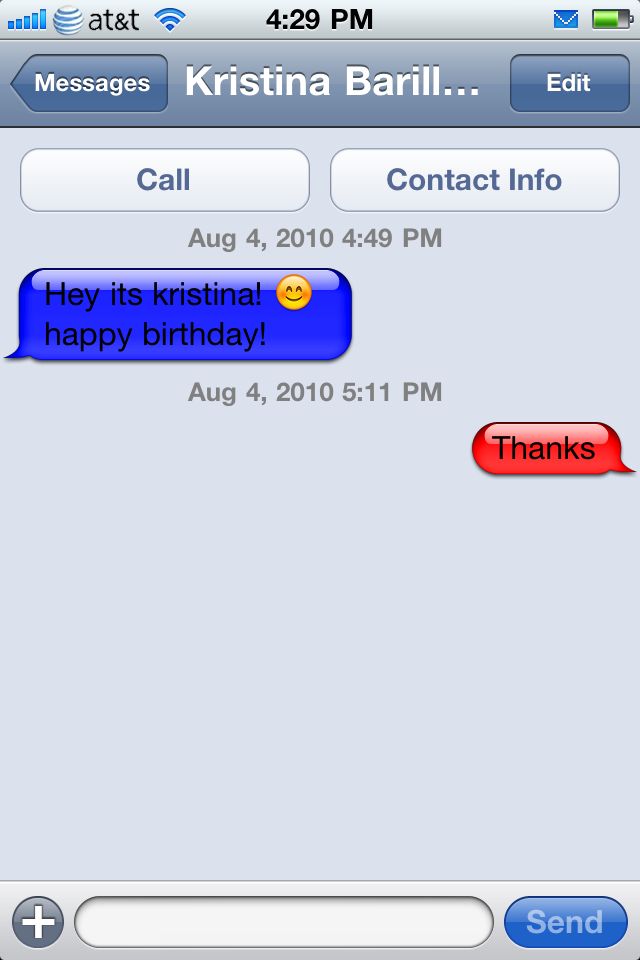

I have seen a couple people asking about custom SMS bubbles. I have made a couple colors and I figured I would offer them if anyone is interested. Attached is a screenshot of red and blue

I definitely want to use red and blue, but the ones on the link where too light and I didn't care for them, how can I go about doing it myself for using a red/blue more like the ones the OP posted a pic of? (I am using bitesms)

These are the Red and Blue bubbles as shown in the first post

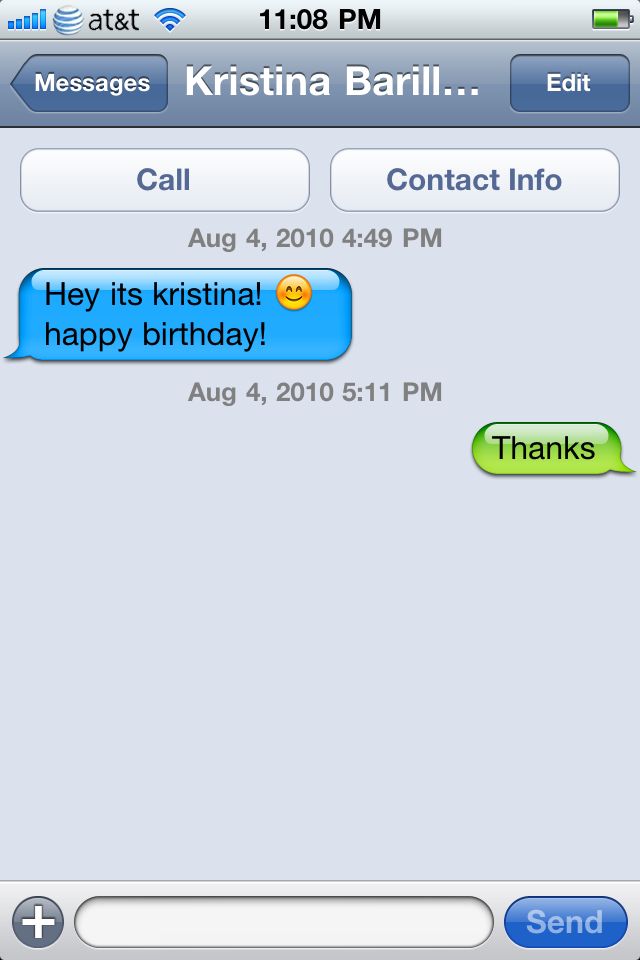

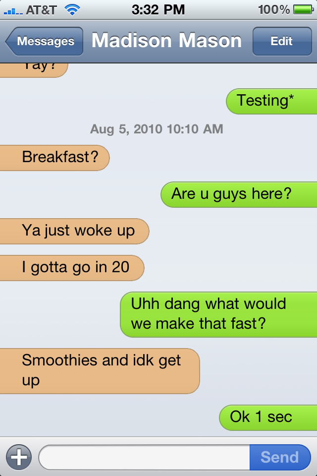

i posted the bubbles i want but those are the iphone original version i need them for iphone 4. and i added the red one posted b4 i guess you can change the color in photoshop but i tried but i cant quite get it like the ones i posted for iphone 2g-3gs
