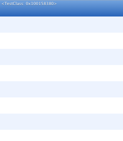

All this code gives me is the attached output. I wanted to give the value of "property1" but all I get is the name of the address of the value!
Can anyone help me?
