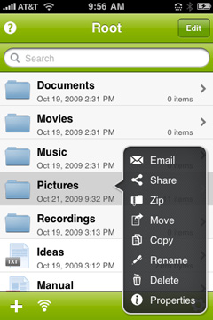

I'm trying to accomplish the effect of the popup like in the screenshot[attached] in a completely unrelated app.
But as i'm typing this, i'm getting some ideas of how to include the tableView. and I'm giving it a try now!! lol!

If you don't need scrolling, I think different people will give you advice whether or not to go with a table view. Personally, I could see arguments for both ways (working with a table view or subclassing a UIView).
In the screenshot, what are people tapping to make your action happen? Is it the icon on the left, the text on the right, or the whole "region"?
The tapping goes throughout, the icon and text both get selected till ends. And Yea, I dont need the scrolling. Whats different from the screenshot is that those are FIXED number of buttons, fixed Box width, height, But in my case thats variable.
