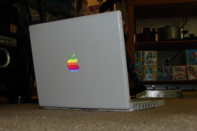

So far I have just changed my Apple .. Needed something a little OldSkool. 😎
Kevin

Well the good news is I am uploading pics and changing the color of the Mac Logo is easy as switching a piece of paper.
The bad news is this is not a painted cover.
Its def Plastic Dye so I am not sure if I should try the dying option above or what but painting it just got a whole lot harder......
It def appears to be unpainted as there are marks in the plastic from the maker that you can not see in the cover.

Now I was just thinking of using a piece of one of my Static Bags for the color on the Mac Logo.... hmm I will have pics up in less then 30 min ^-^
